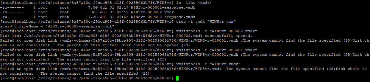

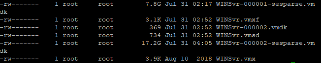

    Posted Aug 13, 2018 11:04 AM
    Can you run the below commands from the VM folder and share the output? I don't see a flat.vmdk file in the above screenshot.
    ls -lrht *vmdk*
    grep -i vmdk "WINSvr.vmx"
    vmkfstools -e "WINSvr-000002.vmdk"
    vmkfstools -e "WINSvr-000001.vmdk"
    vmkfstools -e "WINSvr.vmdk"
    Cheers,
    Supreet
  • 9.  RE: Unable to enumerate all disks
    Posted Aug 14, 2018 04:54 PM
    Here is the screen attachment. Thank you for helping.
  • 10.  RE: Unable to enumerate all disks
    Posted Aug 15, 2018 09:32 AM
    Looks like three main files are missing - WINSvr-000001.vmdk, WINSvr.vmdk and WINSvr-flat.vmdk. The first two files can be recreated but, the flat cannot be. From the root folder of the ESXi, run the command <find . -iname *WINSvr* | grep -i vmdk> and share the output. This will help us identify if the above three files are residing in a different location.
