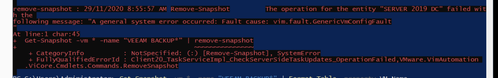

    The backup program creates a snap shot as per usual, however if we consolidate says complete but nothing happens. If you try remove a snapshot manually single, all, children etc keeps failing. I have tried through powercli also and same see error below. We have had to stop backups as our data store is about to run out of space. It’s creating 400GB snapshots and we have about 14 we need removed. Even if we remove every snap shot and start fresh don’t mind.
     thank you

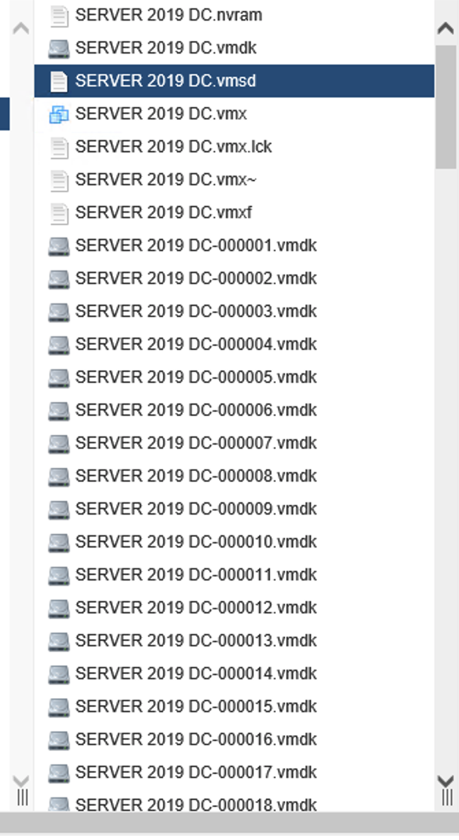

    Appreciate the feedback. Please see attached latest log and vsrm file as only allows me to upload the ZIP. The screen shot below you can see in the data store we actually have about 24 snapshots attached.

    Rule number one when troubleshooting snapshots: DONT USE DATASTORE-BROWSER
    When troubleshooting snapshots you need to see the content of the directory as it really is - not the dumbed down oversimplified version that you see in the datastorebrowser.
    Easiest tool is WinSCP
    With WinSCP you will also see the vmdk-descriptorfiles that I asked for ...

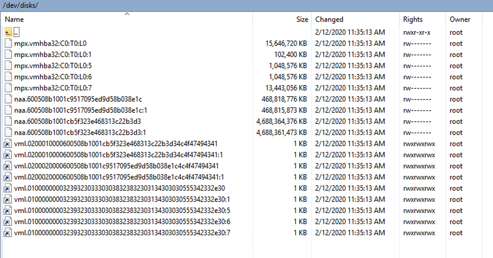

    This is what's listed in the dev/disks as you asked also.
