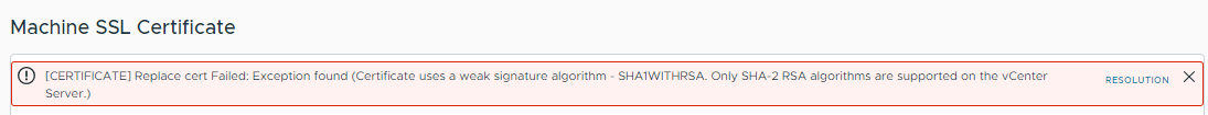

    Hi there!  We have an SSL cert issued by GoDaddy that I'm certain is SHA256:
    However, I get an error when applying this cert that it uses a weak signature algorithm and isn't supported.
    "[CERTIFICATE] Replace cert Failed: Exception found (Certificate uses a weak signature algorithm - SHA1WITHRSA. Only SHA-2 RSA algorithms are supported on the vCenter Server.)"
    Has anyone else run into this issue or have any guidance for me?

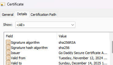

    All certificates in the chain use the "sha256RSA" algorithm and sha256 hash as shown in the screenshot.

    The provided screenshot is from the Machine cert.
    The error would be seen if any cert in the chain has a SHA1. Could you please check the signature algorithm of the intermediate and root cert

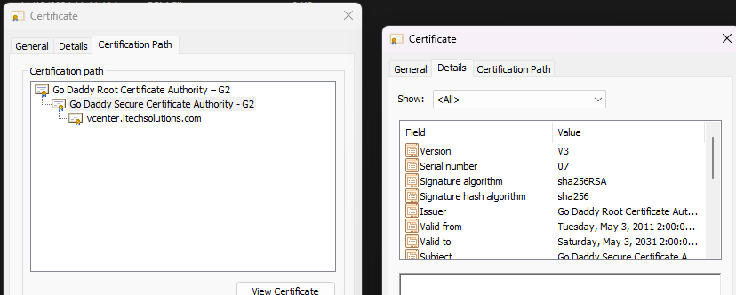

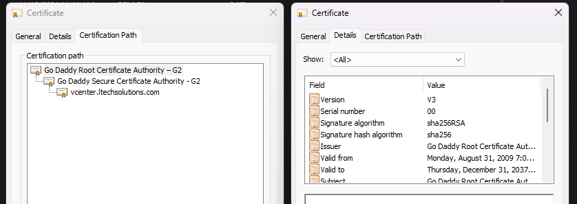

    I did, this is what I meant by "all certificates in the chain," but I can provide screenshots of the others if that would help confirm.

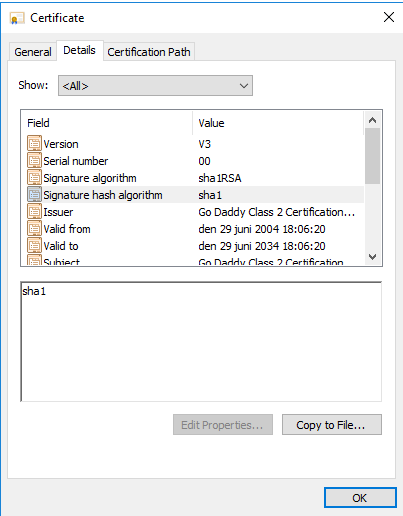

    I have the same problem. And there is a hidden cert in the chain from godaddy. Open gd_bundle-g2-g1.crt in notpad++ and you will see 3 certs. the last one is signed with sha1 :-(

    Oh I see what you did, you're right.... Bummer!  I'm seeing the same thing on mine as well.
