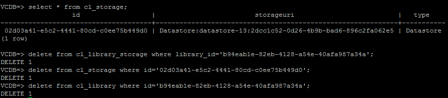

    Most likely a stale entry in VCDB .
    To resolve this issue delete stale entry from VCDB after backing up VCDB.
    1. Take a backup of the VCDB from vCenter Appliance or vCenter server and snapshot of vCenter VM.
    2. Log in to the vCenter server database and execute the following queries to capture the details for the content library.
               - VCDB=# select id,name from cl_library;
                id | name
                8bc3326e-3a0b-49e6-9be0-acb18b91d4b2 | Test
                3b4280d3-b878-4428-85d0-867cb8252e66 | Stale
               - VCDB=# select * from cl_library_storage;
               library_id | storage_id
               8bc3326e-3a0b-49e6-9be0-acb18b91d4b2 | ff3f7160-0731-4d01-9cc0-a2cce03ab3ce
               3b4280d3-b878-4428-85d0-867cb8252e66 | 1325cd29-0b3e-4be4-8445-625da0dce452
               (2 rows)
               - VCDB=# select * from cl_storage;
               id | storageuri | type
               ff3f7160-0731-4d01-9cc0-a2cce03ab3ce | Datastore:datastore-11:f271f3f1-a924-4519-a3f5-e9a75d962888 | Datastore
               1325cd29-0b3e-4be4-8445-625da0dce452 | Datastore:datastore-11:f271f3f1-a924-4519-a3f5-e9a75d962888 | Datastore
               (2 rows)
              - VCDB=# select id,name from vpx_datastore where id=11;
              id | name
             11 | DS1
             (1 row)
    Note: As per the snippets above, we see the id for the library is "3b4280d3-b878-4428-85d0-867cb8252e66". The storage id for the same library is "1325cd29-0b3e-4be4-8445-625da0dce452". When we check the location, we see that the library is saved in the datastore with id "11" (Datastore:datastore-11:f271f3f1-a924-4519-a3f5-e9a75d962888) We can get the datastore name from the datastore table, which is "DS1" here.
    To remove stale entry follow below order.
    VCDB=# delete from cl_library_storage where library_id='3b4280d3-b878-4428-85d0-867cb8252e66';
    VCDB=# delete from cl_storage where id='1325cd29-0b3e-4be4-8445-625da0dce452';
    VCDB=# delete from cl_library where id='3b4280d3-b878-4428-85d0-867cb8252e66';
    The output for each of the above command would return "DELETE 1",Once deleted, we can log in to the web client.

    Hi,
    The procedure works!
    However no idea why the gui klicks didn't work. tail -f /var/log/vmware/content-library/cls.log didn't throw anything obvious (?), saved the cls-xx.log.gz just in case.
    I've recreating a new content library and the sync started as expected.
    Thanks!
