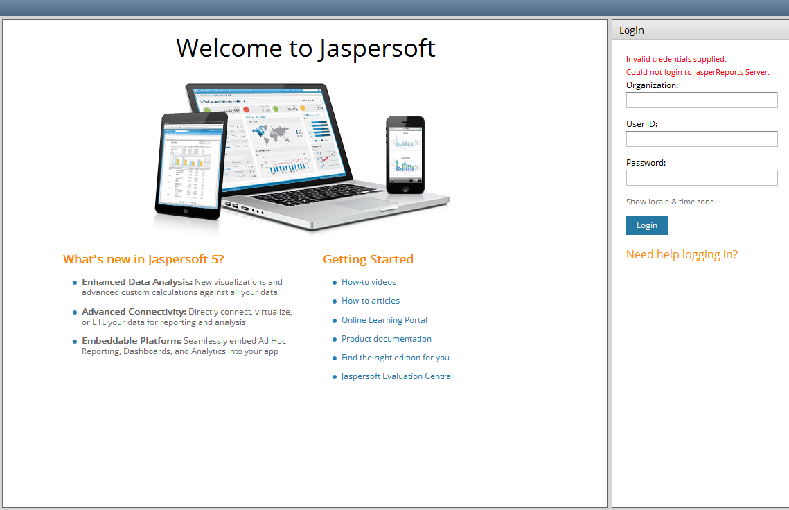

I have reviewed your logs and they all seem fine. The way your login page displays is also okay. Here is as example my page prior to logging in:
The real issue is that your superuser cannot not log in.
It looks like it uses the default MSSQL schema dbo instead of PPM_JASPERSOFT. This happens if the database was created with default schema dbo and remapped manually through SQL Server Management UI later.
