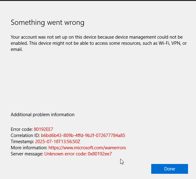

I build this vm to help me connect to a work 365 instance. I have company portal (intune) installed already, and authenticates ok. When I go to setup the actual work account in windows 11 arm pro (latest july patches)... it just errors out. I can't figure out if it's a setting issue, or if it's just not completely recognizing the tpm in fusion.

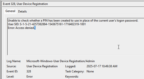

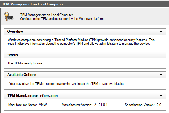

I have the vm guest encrypting with the tpm, windows sees the tpm.... and I can use a "pin" for windows hello to sign in. The work account attempts to connect, and forces me to 2fa on my phone through the ms authenticator app....  but then proceeds to give me this error:
This is the error message from the eventvwr:
The sid referenced in the error refers to my user account. It's a personal ms account.
The instruction when I've been googling keep talking about trying to re-enabled windows hello for business, which I've done multiple ways. The tpm shows that it's ok, and version 2+

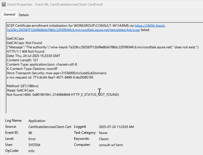

The vm guest that I had working last week with an entra join stopped working likely because of session timeout enforcement settings in our tenant. As a result I built myself another testing vm to see if a change in build process would give me any difference.

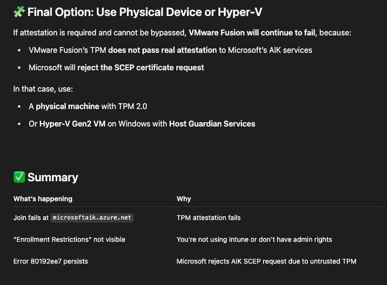

Unfortunately, it has not. However I have been able to determine a few more things in the process. Using chatgpt to help me go through the error messages and other "warning" that I was finding....
The basic jist of the likely root cause is around the fact that the v-tpm does not pass the requirements for the attestation part of the entra/intune join. There is a v-tpm certificate as part of the process which is being rejected:
So, I am presently working on trying to see if I can work around or "exclude" the enrollment restrictions, to see if I can get it to join properly.
That said, what I would like to request, would be if you could research adding the v-tpm certification process as part of your development pipeline. I have found as part of my research lots of people who would like to leverage "vm" to help with testing of autopilot and other intune features.
