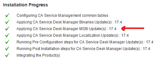

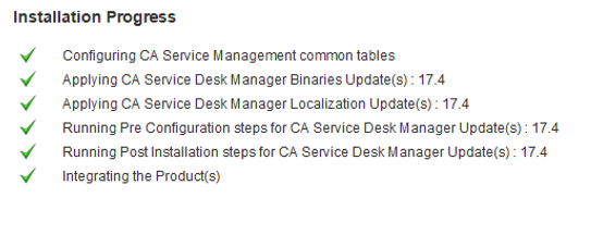

We were wondering: Can we run upgrade wizards like this:
  1. Upgrade BK
  2. Upgrade ST
  3. Upgrade all App Servers at the same time
Keeping in mind that BK and ST server updates do have MDB update step:
And, application servers do not have that step:

Hi
I attempted this once and the one Application server failed.
Most of those steps still interact with the MDB.
Unfortunately (and I would like to be wrong), you need to do them one at a time.
Another reason is that troubleshooting will be a nightmare should/when something fails.
