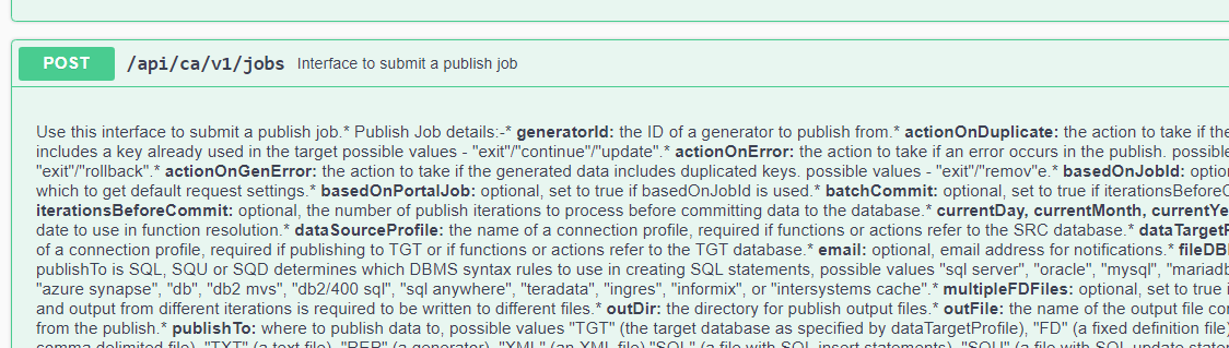

    HI All,
    I am currently using TDMPUblisherservice API call.
    In that I am using an Interface to submit a publish Job.
    In the request body there a list of required field information to be populated.
    I have CSV object registered as table, I need to generate output as a CSV file.
    What are mandatory request body information to be passed to get the status as 200.
    Kindly let me know if we have some sample request body.

    Posted May 27, 2025 07:37 AM
    Hey @Vinoth Gopi
    I'm assuming you trying to use the same API as when you publish a generator and would selecr your output as a CSV file. You have to call the JobService API with a sample payload as follows:
    https://192.168.1.180:8443/TDMJobService/api/ca/v1/jobs
    "name": "Publish to TRAVEL using GEN_TABLE_CIDADES",
    "description": "Publish to TRAVEL using GEN_TABLE_CIDADES",
    "projectId": 2353,
    "versionId": 2354,
    "type": "PUBLISHJOB",
    "origin": "generation",
    "scheduledTime": 1748345426252,
    "email": null,
    "jobs": [],
    "parameters": {
    "variableDefaults": [],
    "generatorId": 2362,
    "jobType": "PUBLISH",
    "title": "Publish to TRAVEL using GEN_TABLE_CIDADES",
    "publishTo": "CSV",
    "repeatCount": "1",
    "tables": [
    "tableNo": 5,
    "tableName": "CITIES",
    "status": 1,
    "fileId": null
    "email": null,
    "actionOnDuplicate": "exit",
    "actionOnGenDuplicate": "exit",
    "dataTargetProfile": "DataTargetProfile_TRAVEL",
    "dataSourceProfile": "DataSourceProfile_TRAVEL",
    "batchCommit": false,
    "iterationsBeforeCommit": 10000,
    "csvDelimiter": ";",
    "csvQuotationMarks": true
    The body could be a bit different depending on your version. This one is the latest one I have in 4.11.1007
    You should be able to identify what needs updating since the fields are self explanatory but if you need additional help, please let me know.

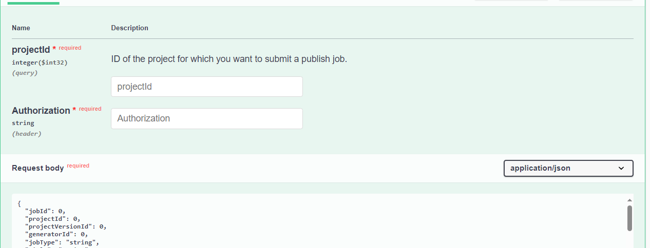

    Posted May 30, 2025 07:33 AM
    Hi Rafael,
    I am trying this currently in the Swagger API. TDMPublsiherService request body.
    I populated the information, but I am getting that error.
  • 10.  RE: TDMPublisherservice

    Posted May 30, 2025 10:13 AM
    Hey Vinoth,
    I have just tried using our Swagger page and as long as I have properly authorized the swagger page and update my job name, description, projecId, versionId and GeneratorId my request goes through.
    You also need to make sure your self signed certificate (if you are using one) is trusted in the browser or the call will fail.
    If you don't mind you can paste the curl command generated by the swagger page here so we check if everything is in order?
