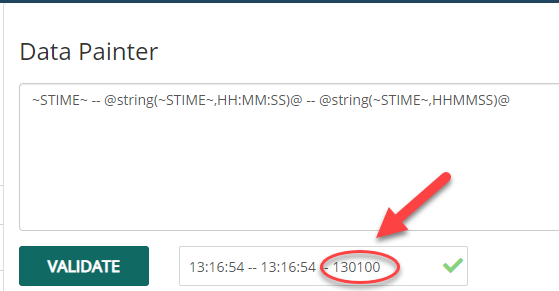

    Hi,
    I'm working on TDm Portal version 4.10.29.
    I'm trying to get a time without separator :.
    The best way I found is to use the STRING function to convert the time value from HH:MM:SS to HHMMSS.
    So, here's what I get:
    ~STIME~ -- @string(~STIME~,HH:MM:SS)@ -- @string(~STIME~,HHMMSS)@
    gives
    13:45:39 -- 13:45:39 -- 130100
    Note that 13:45 is the right time. Each time I tried (within the data painter), the first two are changing accordingly with the real time by the third oen stays always the same.
    I us the REPLACE function as a workaround to remove the separator.
    But, I'm woundering why the STRING result does not give the same time, watever teh format is?
    Any clue?
    Thanks for time
    jf

    My guess would be that we are using a third-party component for the string format of time.
    Probably something native to Java.
    The format you are using of HHMMSS is not generally considered to be a valid date/time format and because it is not the component doesn't know how to handle that situation and is defaulting to some type of output.
    The below link has some possible explanations if you want to dig down into it further.
    Your best option is to use the replace functions you have mentioned.

    Based on that link you would have to open a support case and have the dev team look at the code.
