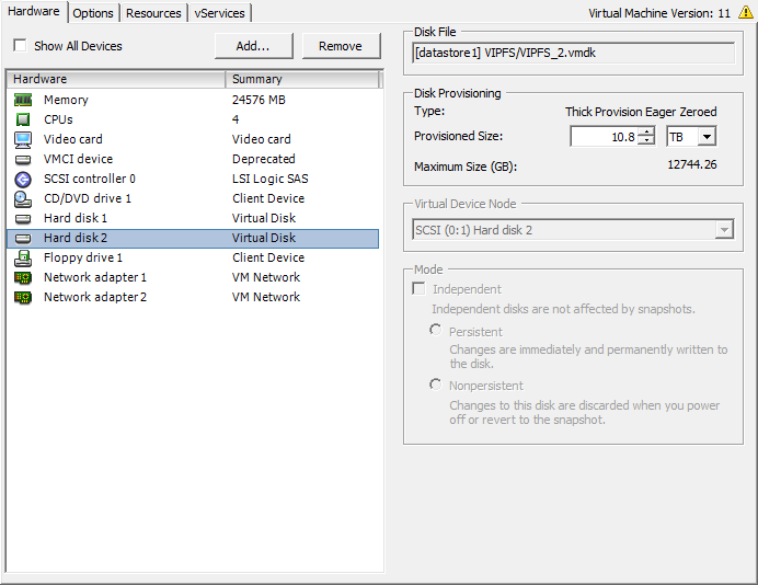

    I would like to build a new Win 2012 R2 VM on the same host, properly configure it and then reattach the 11Tb D: drive to this new VM.
    How can it be done?
    I cannot move/copy the D: drive (VIPFS_2.vmdk) from its original source on datastore because it is too big.
    I want to build new VM with more RAM and CPU cores and reattach large vmdk (with an option to roll back to original VM if needed).

    Creating a new VM and attaching the existing disks to it is easy to do if you want to go this route:
    - Consolidate any snapshots on the disks of the VM (and double-check that this completed by looking at each disk using 'Edit Setttings' and verify they are all poiting to base-disk e.g. VMname.vmdk not snapshots such as VMname-000001.vmdk).
    - Power off the existing VM, and unregister it from the host ('Remove from inventory')
    - Create a new VM, customise as needed  and attach the existing disks - Remove the default existing disk, select 'New device' Select 'Existing Hard Disk' click 'Add', navigate to the location on datastore that the original VM disks are located and add each disk
    When doing this, ensure that you are adding each disk as they were on the original VM, e.g. the boot disk should be attached at 0:0, and any other disks that are attached to seperate controllers should be added correctly after adding the relevant controller (e.g. add a second SCSI Controller and add disks at 1:0 etc.).
    You can of course create a VM and remove/add disks after creation.

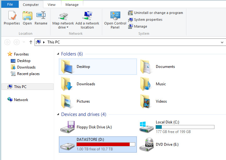

    FYI my goal here is to create NEW VM with NEW C: drive (fresh OS) but use OLD D: drive from old VM (11Tb) which is full of data.
    I do not have any snapshots of this vmdk. I simply do not have space on the server for a snapshot of 11Tb D: drive.

    When creating new VM I want to create new bootable OS C: drive but then attache D: drive from old VM.
    Should I create D: drive at a time of new instillation and then just replace it with old D: drive or just attach it later as old D: drive from my old VM?
    This drive to be retired on old VM and replaced with new C: drive on new VM with fresh OS install.
    The below drive to be MOVED to new VM with all data intact.

    You don't have to move it, you are merely repointing the new VM to the original disk descriptor and location.
    So provided there is access to that datastore you can add that large data disk to a new VM with a new OS (assuming it is a compatible or same OS) as a data drive, it should be picked up as a drive in the Guest OS (likely D:).
    The only thing to mention is put them on the same SCSI controllers, you only have one here (SCSI controller 0) so basically only needs the new boot OS on 0:0 and the data drive on 0:1 (or any other connection other than 0:0 which is default boot).
    No need to attach a dummy drive on VM creation and add later - you can add the original data disk to the new VM during VM creation using the steps I provided previously.
    (or attach it later, either works). Though I will mention that you should consider testing this VM without data drive and also try a second SCSI controller for the data drive as Madmax01​ advised.
