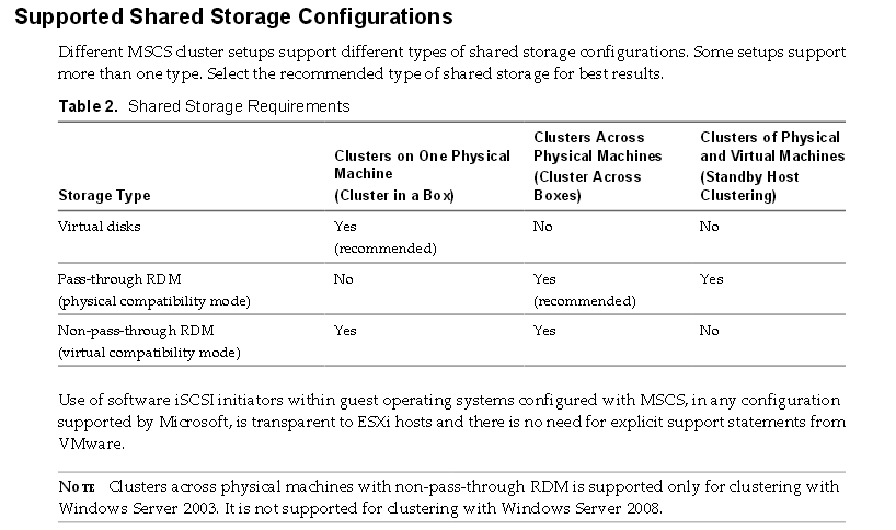

    It can be seen on Failover Clustering guide that
    http://pubs.vmware.com/vsphere-50/topic/com.vmware.ICbase/PDF/vsphere-esxi-vcenter-server-50-mscs-guide.pdf
    Windows Server 2003 was/is still supported for CAB in RDM virtual compatibility mode. On a seperate KB article it states that vMotion across hosts with RDM physical compatibility mode is supported.

  • 7.  RE: Microsoft Clustering Across Boxes (CAB) and vMotion, RDM Mode
    Posted Aug 03, 2015 03:21 PM
    We have a 2008 MSCS cluster setup with Physical mode RDM's within ESXi 5.0. I was looking over the whitepaper I used to setup the cluster, and as vGuy‌ says, it does state that Migration with vMotion of clustered virtual machines is a setup limitation of the MSCS configuration. Have a look at this table that shows the different clustering solutions.
