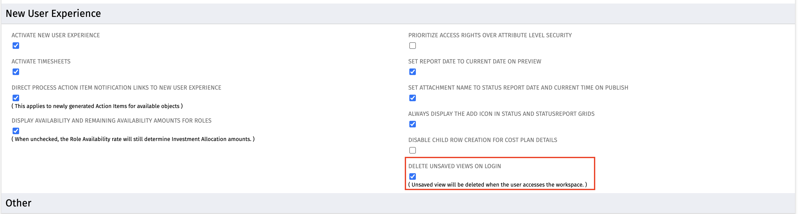

    Which version are you on? At least from 16.2.3 version on, there is a central admin area, where you can administer all saved views: ModernUX -> Administration -> Views. An admin should be able to delete said view, even if its not shared. But only, if the view was saved. If its in a temporary state (=formatted in italic), it may get tricky: In newer versions there is a system wide option, to delete "temporary views" on logout. But Im not sure where that option is.

    Your tip about the system option "Delete temporarie views" was true gold and solved the issue. Thank you very much.

    Broadcom Employee
    Posted Aug 11, 2025 12:33 PM
    Hi,
    Depending on the version you are on, we do offer the ability to delete all unsaved views when people log out (version 16.3.2, I think)  You can enable this setting, have the user log in with a view that works, then have them log out.
