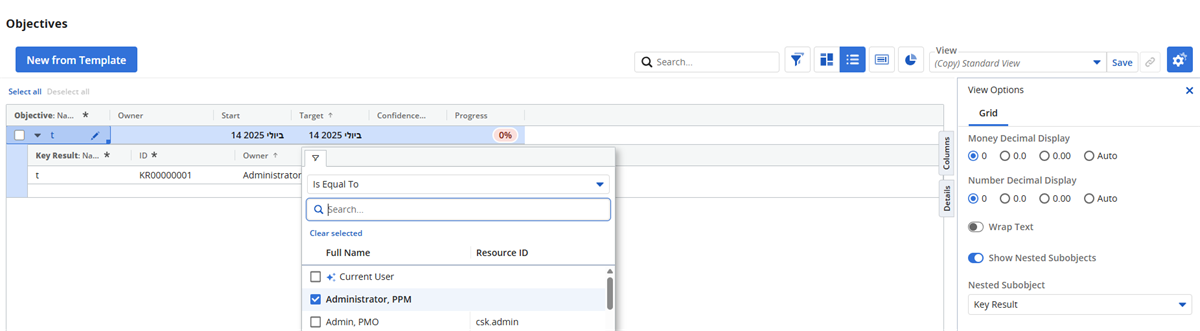

    Posted Jul 14, 2025 09:24 AM
    You have an option in the AG-Grid interface to perform filters on each grid.
    I attached a picture, let me know if you succeeded, I'd be happy to help

    Posted 22 days ago
    Hi Dor, but there is no way to filter based on a specific sub object type. In this case their "order" object
