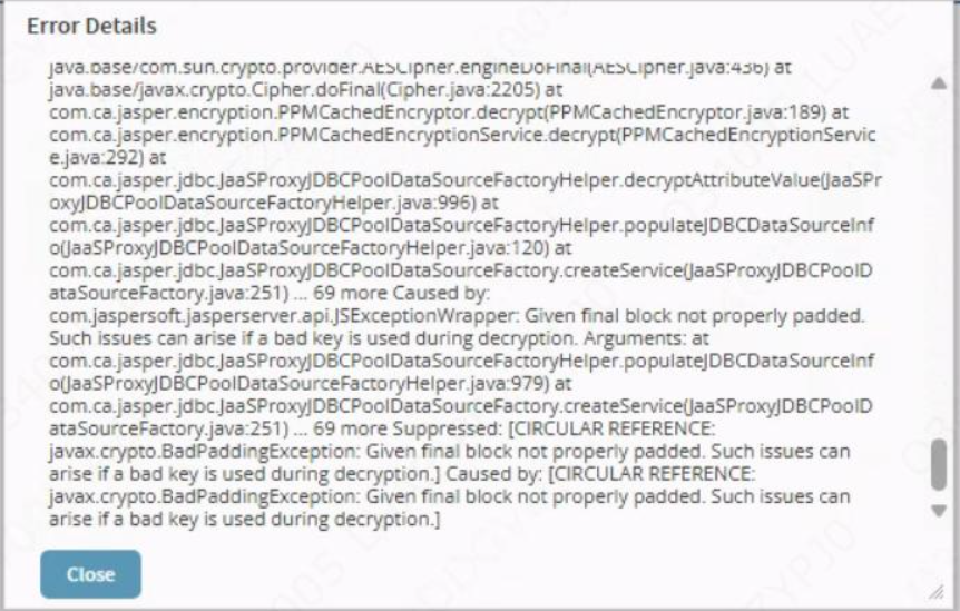

    Problem:
    When they are trying to execute a report from Advanced Reporting, they get below error message:
    Customer did following to rectify above error:

    Any suggestions or pointers to explore to resolve the error?

    Looking at the problem it seems the bean connection is unable to connect to clarity, so we need to check Clarity connection if its encrypted. Make sure the bin directory doesn't have custom libraries.

    By "we need to check Clarity connection if its encrypted" do you mean Clarity + JaspertSoft authentication using integration keys? Or trustServerCertificate parameter in the JDBC URL for Clarity and DWH databases in Clarity's properties.xml? By default it is set to "true" but when it is set to "false" client has to validate Server's SSL\TLS certificate. Please share if you are referring to this?
    By "bin directory doesn't have custom libraries." you mean bin directory of Clarity or JasperSoft? And I assume by "Custom library" you meant any non out of the box library? Right?

    That's correct and also compare the Clarity_home\lib matches with OOTB and no custom libraries are stored in Clarity_home\lib directory

    Couple common troubleshooting items:
    • If jasper's is running on HTTPS using a self signed cert, ensure its trusted by Clarity's cacerts
    • regenerate the certificates for the trust between the apps
    • place them in the jasper folder and restart the app
    • Then run the 2 commands you are trying to run
