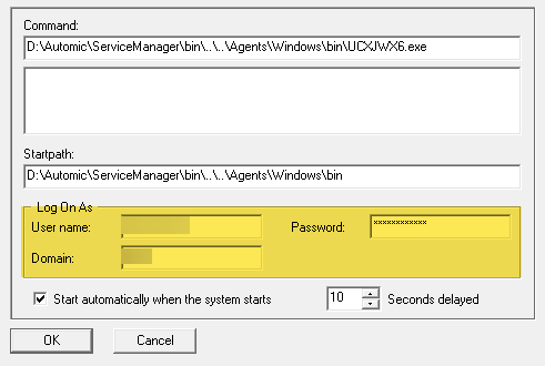

    We were able to determine the cause which seems to be a combination of things. This issue seems to stem from the newer windows agent ignoring the credentials in the login object.

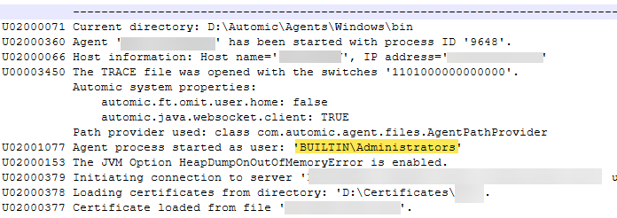

    When the agent starts up we see that it is not using the defined account, but instead is using the BUILTIN\Administrators account
    The agent starts and appears to be running but no jobs actually get executed and in the logs we see the original message I started the post with.
    U02000009 Job 'JOBS.VERIFY_WINDOW' with RunID '1126014' ended with return code '-1073741502'.

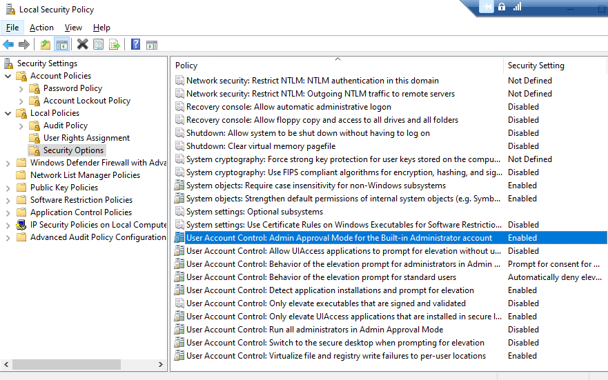

    We determined this code related to code trying to interact with the desktop. So this led to the CAU settings.

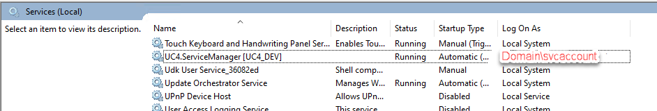

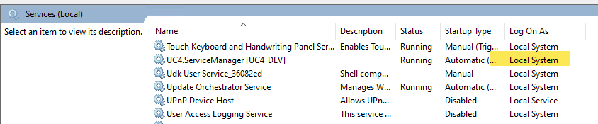

    Our security requirements don't allow us to change this setting so In order to get the new windows agent to function I needed to change the login account for the service manager to use the desired service account which seems to defeat the purpose of the login object.
    Before:
    After:
