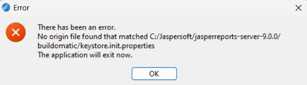

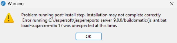

    I'm getting the first error during installation and the second error post installation, how can i fix them?
    Can You help me,
    Jan
    OS: WNDOWS Server 2019 Eng, DB: Postgres

    Did you use the UI installer or the WAR install process to install JasperSoft?

  • 3.  RE: Errors during and post installation of JasperReports Server
    Posted Aug 20, 2024 08:14 AM
    I use the UI installer

    Hi,
    For using the JRS 9.0.0 Binary installer i.e.TIB_js-jrs_9.0.0_win_x86_64.exe, as a pre requisite, supported java has to be installed.
    I think above errors shown in screen shot are because of supported java is not present.  Please install supported java before using binary installer for installing JRS 9.0.0.
    For more information, please refer Broadcom  JRS 9.0.0 documentations at JRS900techdocs.
