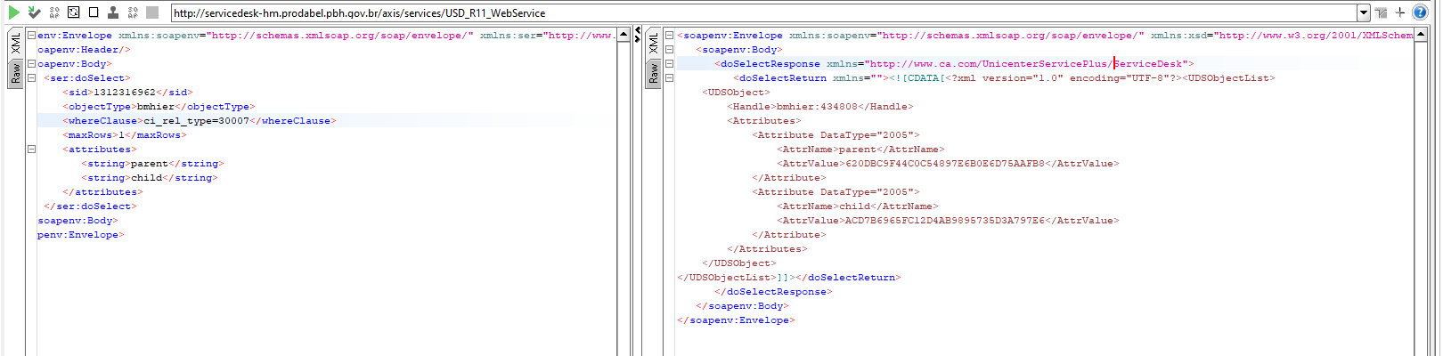

    When I execute the DOSELECT method using the following where clause:
    parent=2AB2C52E288D8842A9158CFA9C4F0C60 and ci_rel_type=30007
    I get the following error:
    <ErrorMessage>Error fetching: AHD03053: Incorrect Where clause: Parse error at: "parent=2AB2C52E288D8842A9158CFA9C4F0C60 and ci_rel_type=30007" (Bad where clause)</ErrorMessage> as shown below:
    However, if I use only ci_rel_type in the where clause, the value is returned correctly, as shown below:
    Does anyone know what I am doing wrong in the where clause when I include the parent ID?

    You must use the follow wc code syntax:
    parent=U'2AB2C52E288D8842A9158CFA9C4F0C60' and ci_rel_type=30007

    Hi @Felipe V,
    It worked! I had forgotten that this syntax was also an option.
    Thanks a lot for the support!
