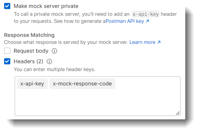

    To test the callback capability, you can use the mock server function in Postman.
    (Be sure to consider any firewall between your AE system and the listening application. See Specifying a proxy for callbacks, below.)

    The x-api-key header is used to grant authorization to a private mock server.
    The x-mock-response-code header serves two purposes:
    • When the mock server receives a request, Postman uses this header to identify which example to match in the collection.
    • The mock server returns the specified HTTP response code to the JWP executing the callback.
    The mock server is configured as follows:
    The AE will mark the callback task ENDED_OK upon receiving any successful (2XX) HTTP response code from the callback listener.
    The body and actual response code of the callback response are evidently discarded. If you want to somehow communicate back from the callback listener to the AE that the callback was not successful, you would have to configure it to return a client error (4XX) response code such as 404. This causes the AE to mark the callback task ENDED_NOT_OK. You might want to do this if the AE callback for some reason includes a Run ID that cannot be associated with a task executed by the external application. (And it might be possible to perform some additional checking of CBCK tasks via AE scripting.) To test this, I created a second executions example wherein x-mock-response-code and the expected response code are set to 404.
