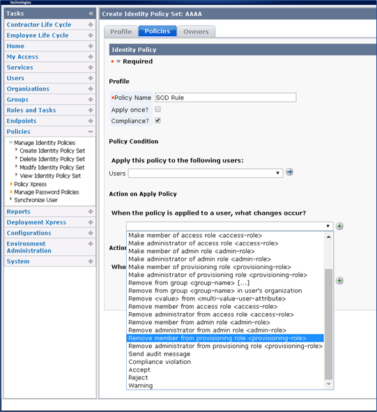

    1) IM already has SOD enforcement
    Enforcing Segregation of Duties Requirements - CA Identity Manager - 14.2 - CA Technologies Documentation
    Compliance Support - CA Identity Manager - 14.2 - CA Technologies Documentation

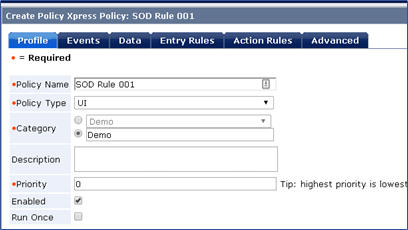

         i) Either PX UI Rules to enforce what is selected; let it read the custom labels between all selected roles and prevent submissions.

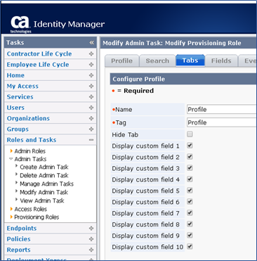

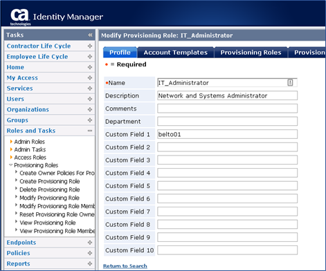

    Example:  Enable Prov Role ten (10) custom fields to be usable for PX Rules and viewable in IM UI:

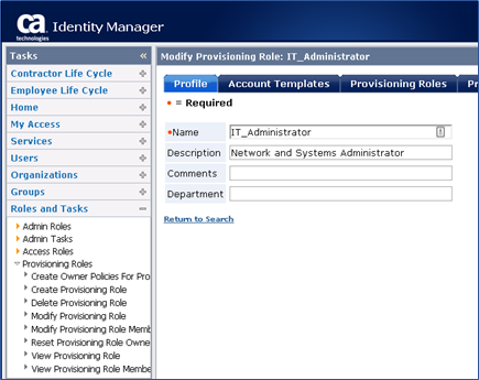

    BEFORE:
    Update to the Profile's Screen; enable all check boxes & submit.
    AFTER:
