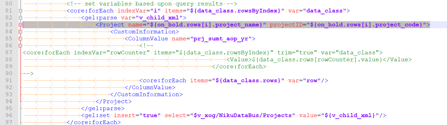

    It looks like int line 78 you are writing over your rows with a single row.
    So when you get to line 102, you no longer have a arraylist of rows but just a single row.
    So data_class.rows[i].value returns a null / empty string.

    I didn't understand line 83.  You are iterating over the data_class rows but using the index on the on_hold_rows.  Given the query for on_hold_rows, it looks like it should only have one row in the results set.

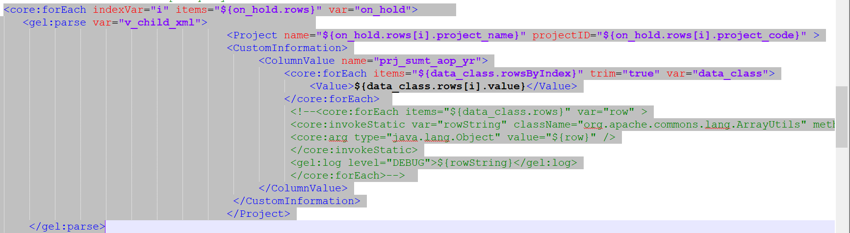

    Project ID and Project Name -> On_Hold_rows which contains only one row but data_class contains two rows. I am not sure where should
    This is the XOG INPUt getting generated with the empty values
    <NikuDataBus xmlns:xsi="http://www.w3.org/2001/XMLSchema-instance" xsi:noNamespaceSchemaLocation="../xsd/nikuxog_project.xsd"> <Header action="write" externalSource="NIKU" objectType="project" version="15.6"/> <Projects> <Project> <CustomInformation> <ColumnValue name="prj_sumt_aop_yr"> <Value/> <Value/> </ColumnValue> </CustomInformation> </Project> </Projects> </NikuDataBus>
    Error Message :
    <XOGOutput xmlns:xsi="http://www.w3.org/2001/XMLSchema-instance" xsi:noNamespaceSchemaLocation="../xsd/status.xsd"> <Object type="project"/> <Status elapsedTime="0.0 seconds" state="FAILURE"/> <Statistics failureRecords="0" insertedRecords="0" totalNumberOfRecords="0" updatedRecords="0"/> <ErrorInformation> <Severity>FATAL</Severity> <Description>[Error] :1:1: element "Project" is missing "projectID" attribute </Description> <Exception type="java.lang.Exception">Invalid xml data</Exception> </ErrorInformation> </XOGOutput>
    This is how I updated logic now. I am NOT sure where it is pulling empty values.
  • 10.  RE: Re: Gelscript for Multi-valued Lookup that can have anywhere between 0 & 9 entries.
    Posted Aug 29, 2019 10:25 AM
    Now I have changed the code
    <core:choose><core:choose>      <!--  If there is an exception log it -->      <core:when test="${dbException != null}">        <gel:log level="ERROR">Database Error while querying data : ${dbException}</gel:log>      </core:when>      <core:otherwise>        <!-- set variables based upon query results -->        <core:forEach indexVar="i" items="${on_hold.rows}" var="on_hold">               <core:set value="${on_hold.get('project_code')}" var="v_proj_code"/>    <gel:log level="DEBUG">${on_hold.get('project_code')}</gel:log>               <core:set value="${on_hold.get('project_name')}" var="v_proj_name"/>     <gel:log level="DEBUG">${on_hold.get('project_name')}</gel:log>            <gel:parse var="v_child_xml">                                                           <Project name="${v_proj_name}" projectID="${v_proj_code}" >                                           <CustomInformation> <ColumnValue name="prj_sumt_aop_yr"> <core:forEach items="${data_class.rowsByIndex}" trim="true" var="data_class"> <Value>${data_class.rows[i].value}</Value> </core:forEach>  <!--<core:forEach items="${data_class.rows}" var="row" >                                                     <core:invokeStatic var="rowString" className="org.apache.commons.lang.ArrayUtils" method="toString" >                                                     <core:arg type="java.lang.Object" value="${row}" />                                                     </core:invokeStatic>                                                     <gel:log level="DEBUG">${rowString}</gel:log>                                                     </core:forEach>-->  </ColumnValue> </CustomInformation>                                           </Project>            </gel:parse>              <gel:set insert="true" select="$v_xog/NikuDataBus/Projects" value="${v_child_xml}"/>                </core:forEach>             </core:otherwise>                    </core:choose>
    Now XOG is getting generated
    XOG_INPUT = <NikuDataBus xmlns:xsi="http://www.w3.org/2001/XMLSchema-instance" xsi:noNamespaceSchemaLocation="../xsd/nikuxog_project.xsd"> <Header action="write" externalSource="NIKU" objectType="project" version="15.6"/> <Projects> <Project name="AOP Test 1.2" projectID="PRJ00880"> <CustomInformation> <ColumnValue name="cmi_prj_sumt_aop_yr"> <Value/> </ColumnValue> </CustomInformation> </Project> </Projects> </NikuDataBus>
    I am getting this error message now
    XOG_OUTPUT = <XOGOutput xmlns:xsi="http://www.w3.org/2001/XMLSchema-instance" xsi:noNamespaceSchemaLocation="../xsd/status.xsd"> <Object type="project"/> <Status elapsedTime="4.336 seconds" state="FAILURE"/> <Statistics failureRecords="1" insertedRecords="0" totalNumberOfRecords="1" updatedRecords="0"/> <Records> <Record> <KeyInformation> <column name="ID">5070096</column> <column name="name">AOP Test 1.2</column> <column name="UNIQUE_NAME">PRJ00880</column> </KeyInformation> <ErrorInformation> <Severity>FATAL</Severity> <Description>Project Object update failed</Description> <Exception><![CDATA[ java.lang.Exception: INV-0021: Planned Cost Finish date is earlier than Planned Cost Start date at com.niku.xog.util.XOGContinueHandler.postProcess(XOGContinueHandler.java:38) at com.niku.xql2.XQLVisitor.postProcess(XQLVisitor.java:1417) at com.niku.union.xml.dom.DOMWalker.postProcess(DOMWalker.java:210) at com.niku.union.xml.dom.DOMWalker.traverseIntern(DOMWalker.java:94) at com.niku.union.xml.dom.DOMWalker.traverseIntern(DOMWalker.java:92) at com.niku.union.xml.dom.DOMWalker.traverse(DOMWalker.java:51) at com.niku.xql2.handlers.MatchHandler.preProcess(MatchHandler.java:129) at com.niku.xql2.XQLVisitor.preProcess(XQLVisitor.java:1383) at com.niku.union.xml.dom.DOMWalker.preProcess(DOMWalker.java:194) at com.niku.union.xml.dom.DOMWalker.traverseIntern(DOMWalker.java:74) at com.niku.union.xml.dom.DOMWalker.traverse(DOMWalker.java:51) at com.niku.xql2.handlers.TryHandler.preProcess(TryHandler.java:54) at com.niku.xql2.XQLVisitor.preProcess(XQLVisitor.java:1383) at com.niku.union.xml.dom.DOMWalker.preProcess(DOMWalker.java:194) at com.niku.union.xml.dom.DOMWalker.traverseIntern(DOMWalker.java:74) at com.niku.union.xml.dom.DOMWalker.traverse(DOMWalker.java:51) at com.niku.xql2.handlers.LoopHandler.processObject(LoopHandler.java:388) at com.niku.xql2.handlers.LoopHandler.processSet(LoopHandler.java:259) at com.niku.xql2.handlers.LoopHandler.preProcess(LoopHandler.java:216) at com.niku.xql2.XQLVisitor.preProcess(XQLVisitor.java:1383) at com.niku.union.xml.dom.DOMWalker.preProcess(DOMWalker.java:194) at com.niku.union.xml.dom.DOMWalker.traverseIntern(DOMWalker.java:74) at com.niku.union.xml.dom.DOMWalker.traverse(DOMWalker.java:51) at com.niku.xql2.handlers.LoopHandler.processObject(LoopHandler.java:388) at com.niku.xql2.handlers.LoopHandler.processSet(LoopHandler.java:259) at com.niku.xql2.handlers.LoopHandler.preProcess(LoopHandler.java:216) at com.niku.xql2.XQLVisitor.preProcess(XQLVisitor.java:1383) at com.niku.union.xml.dom.DOMWalker.preProcess(DOMWalker.java:194) at com.niku.union.xml.dom.DOMWalker.traverseIntern(DOMWalker.java:74) at com.niku.union.xml.dom.DOMWalker.traverse(DOMWalker.java:51) at com.niku.xql2.handlers.LoopHandler.processObject(LoopHandler.java:388) at com.niku.xql2.handlers.LoopHandler.processSet(LoopHandler.java:259) at com.niku.xql2.handlers.LoopHandler.preProcess(LoopHandler.java:216) at com.niku.xql2.XQLVisitor.preProcess(XQLVisitor.java:1383) at com.niku.union.xml.dom.DOMWalker.preProcess(DOMWalker.java:194) at com.niku.union.xml.dom.DOMWalker.traverseIntern(DOMWalker.java:74) at com.niku.union.xml.dom.DOMWalker.traverseIntern(DOMWalker.java:92) at com.niku.union.xml.dom.DOMWalker.traverseIntern(DOMWalker.java:92) at com.niku.union.xml.dom.DOMWalker.traverse(DOMWalker.java:36) at com.niku.xog.service.XOGXBLHandler.processXBL(XOGXBLHandler.java:261) at com.niku.xog.service.XOGXBLHandler.process(XOGXBLHandler.java:168) at com.niku.xog.service.ObjectHandler.processRequest(ObjectHandler.java:180) at com.niku.xog.service.ObjectHandler.process(ObjectHandler.java:97) at com.niku.xog.service.XOGDispatch.processMessage(XOGDispatch.java:133) at co
  • 11.  RE: Re: Gelscript for Multi-valued Lookup that can have anywhere between 0 & 9 entries.
    Posted Aug 29, 2019 12:26 PM
    Thank you Eugine, I got the point where it messed up and I have corrected it. Now I get some weird error that Planned Cost Finish date is earlier that Planned Cost Start date when it is Xogging the data. I am working on it to figure it out
