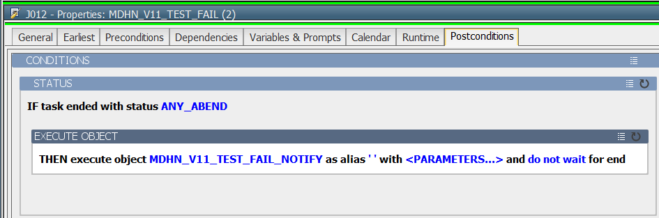

    Just to add, as I am new to V11 I set up a simple test.  First I attempted to do it the V8 way by adding my notification to the task's Properties Dependencies tab enabling the Else / Execute attributes and it operated the same as V8; it did not execute the notification object.
    I next used the task's Postconditions tab with the following and it executed the notification. This seems too easy and obvious so I must be missing something! Obviously this needs more testing but at least it appears to work as needed.

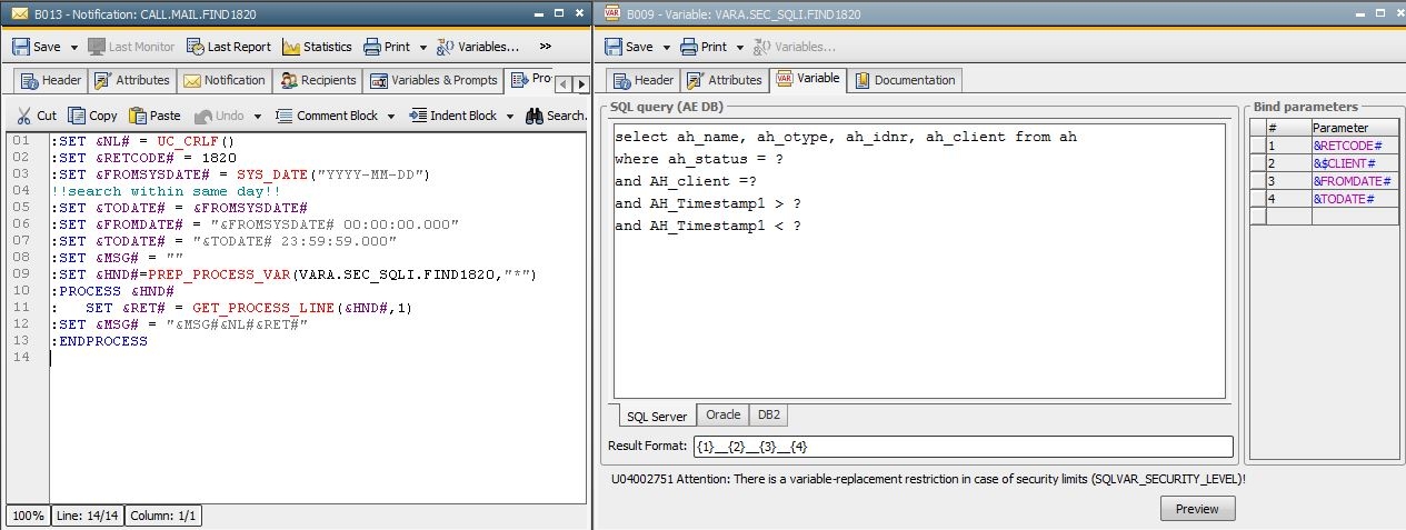

    Posted Oct 14, 2016 05:13 AM
    meanwhile I can provide you with mine - runs once a day and comes per mail
