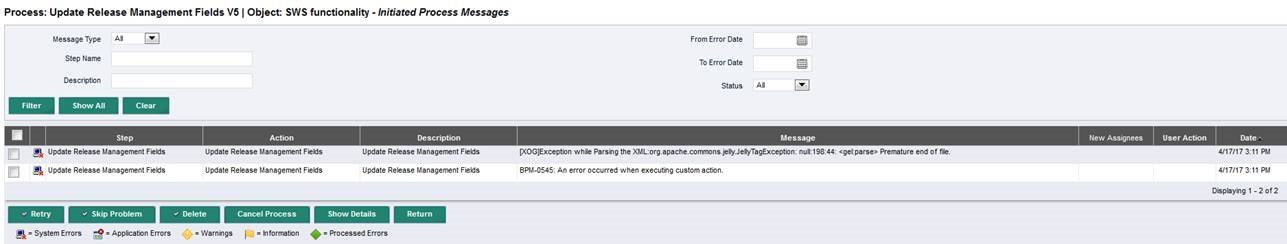

Hi David,
Thanks for getting back on this very soon.
That is the error i get when i run the process and below is the code for the process.

Please check and help in this.
Thanks in advance.
