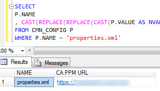

    SELECT
    P.NAME
    , CAST(REPLACE(REPLACE(CAST(P.VALUE AS NVARCHAR(MAX)),'utf-8','utf-16'), '&', '&') AS XML).query('data(/properties/webServer/webServerInstance[@id="app"]/@sslEntryUrl)') as 'CA PPM URL'
    FROM CMN_CONFIG P
    WHERE P.NAME = 'properties.xml'
    Things I have learned this morning (we're MSSQL Server, Oracle will certainly be different):
    1) The Value column's data type is ntext. This needs to be converted to an XML data type.
    2) The properties file is UTF-8. This needs converted to UTF-16 and on MSSQL you need to convert the ntext to nvarchar first.
    3) Ampersands sting.
    Surely there has to be an easier way than this - but we're done here. I'm chewing on the Idea for making this easier. So far I think the easiest approach would be to add another column to CMN_CONFIG with a Data Type in MSSQL of 'XML' and  'XMLType' in Oracle and keep a copy of the properties.xml there as well, that way we can simply xPath our way into this data without having to jump through character and data type hoops.
