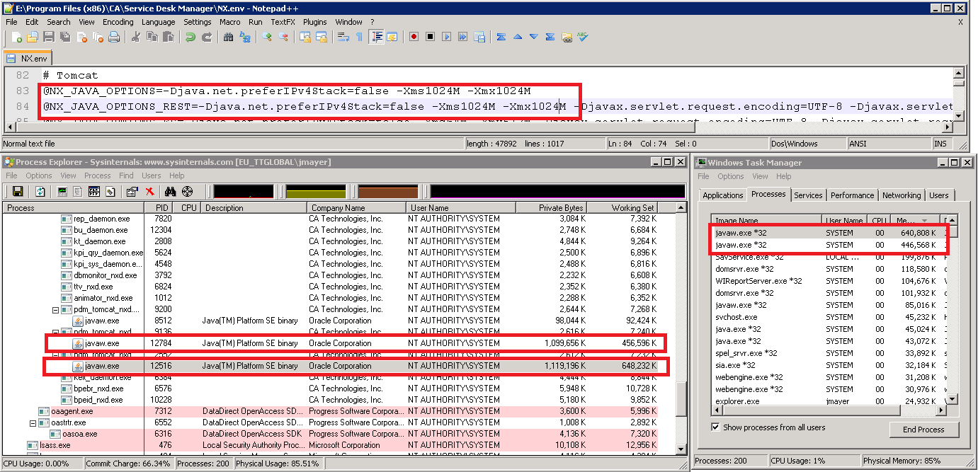

Heap Memory
Out of the box configuration the heap memory to be consumed by tomcat in set relatively low and you may want to increase base on your need and size of system RAM.
This settings can be modified in the nx.env and will require a restart of the tomcat container
@NX_JAVA_OPTIONS=-Djava.net.preferIPv4Stack=false -Xms64M -Xmx1024M
the -Xms switch determine the minimum memory size used at the started of the container
the -Xmx switch determine the maximum size that can be used by the container.
I often recommend to put the size of the -Xmx to 50% of you available RAM but if you run multiple application on that server you may want to go to a lower number.
You can configure those parameters for each of your tomcat container (REST, SA, Visualizer) but the total of those must not exceed more that 60% of your total system memory available to avoid impacting others components of your system.
If you have enough memory available, you can set the minimum and maximum heap to the same size to avoid garbage collection to happen too frequently. Garbage collection is an intensive consumer of CPU resource and much you can avoid it better it will be.
Please consider that this is a costly memory process as those memory will be reserve to Tomcat and can't be used by others application. Then size your RAM accordingly or try to compromise the ratio between the Xms and XmX that better suite your system
The example below will allocate and reserve 2gb of memory and prevent garbage collection until then
@NX_JAVA_OPTIONS=-Djava.net.preferIPv4Stack=false -Xms2048M -Xmx2048M
Note that this is just example and you need to fine tune to suit your needs.
