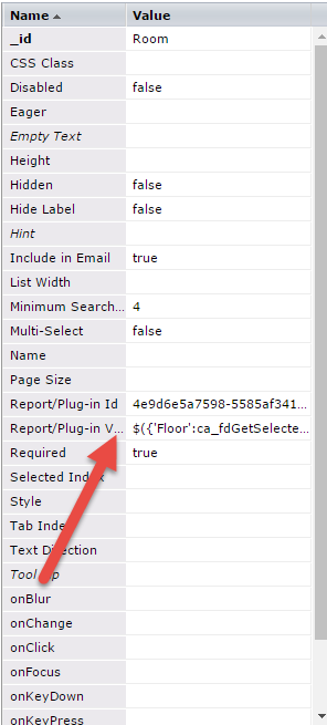

    We have a dropdown on a catalog form referencing a report builder data object. Within the query of that object we are referencing a couple of variables.
    The dropdown on the form is then using the "Report/Plug-in Variable" value to reference two other dropdowns and filter the number of options in that dropdown.
    These are both working successfully when used independently. We have been unsuccessful in getting them to work together.
    $({'Floor':ca_fdGetSelectedOptionValues('ConfRoom','RoomFloor')})

    Hi Alex,
    You can pass multiple variables as a JSON expression similar to the following:
    $({'userid':_.user.id,'rm_orgunit':ca_fdGetSelectedOptionValues(ca_fd.formId,'orgunit_id')})
    This is from the following:
    Elements of a Form - CA Service Management - 14.1 - CA Technologies Documentation
