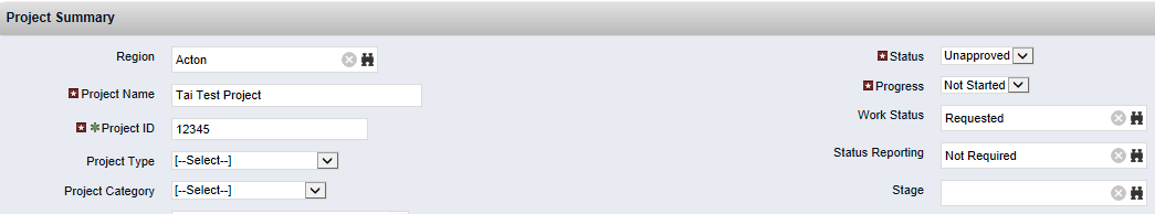

    Hi Dave,
    So basically the Region field is a dynamic lookup field.  The user selected Acton as a region, I'll write a gel script to update the Project Name to Region_name_ZipCode based on this selection.  My issue for now, I'm having problem getting the Acton value from the Region field for this project.  I've been getting Null value from my query.
    Hopes that explain it.
    Thanks,
    Tai
