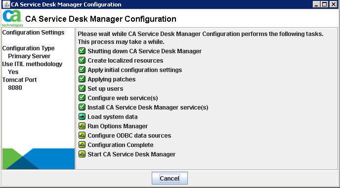

    Hi all,
    I have an old 12.6 system, I just poweredon the app server and moved its database to my test environment and I want to start the SDM
    But pdm_configuration stucks at Load System Data step, without any logs in neither sdtlog nor configure log.
    DB access is granted from this primary server.
    Where should the error? Which controls do I have to run?

    Posted Apr 15, 2016 02:34 PM
    any other idea?
    I'm waiting for 40 minutes but nothing logged in configure.log file

  • 17.  Re: pdm_configure load system data
    Posted Apr 20, 2016 09:31 AM
    It stucks here
    DEBUG ProcessUtilities.java   401 Executing command: dbload.exe -M C:\PROGRA~2\CA\SERVIC~1\data\docres.dat

  • 22.  Re: pdm_configure load system data
    Posted Aug 02, 2017 09:35 AM
    Hi, today i have the same problem, stuck in step "Load System Data" SDM Version 12.6 and moving the DB from SQL2008 to SQL2012. After de stuck i do the cancel of the Configure process.
    Following these steps the Configure works:
    Stop all CA* services running in Windows (SDM and others) (if SDM didn't finish, kill the process pdm_proctor_nxd_32 from task manager)
    Run Configure (run as administrator)
    Regards
  • 23.  Re: pdm_configure load system data
    Best Answer
    Broadcom Employee
    Posted Aug 02, 2017 10:04 AM
    Hi,
    did you link the service desk user in the SQL 2012 database after restoring the mdb database? If you didn't perform this step servicedesk user cannot log into SQL.
    (sp_change_users_login 'Auto_Fix', 'servicedesk' ) - must be executed on the mdb database. The exact syntax depends on SQL version.
    Hope this was useful.
    Regards,
    Kurt
