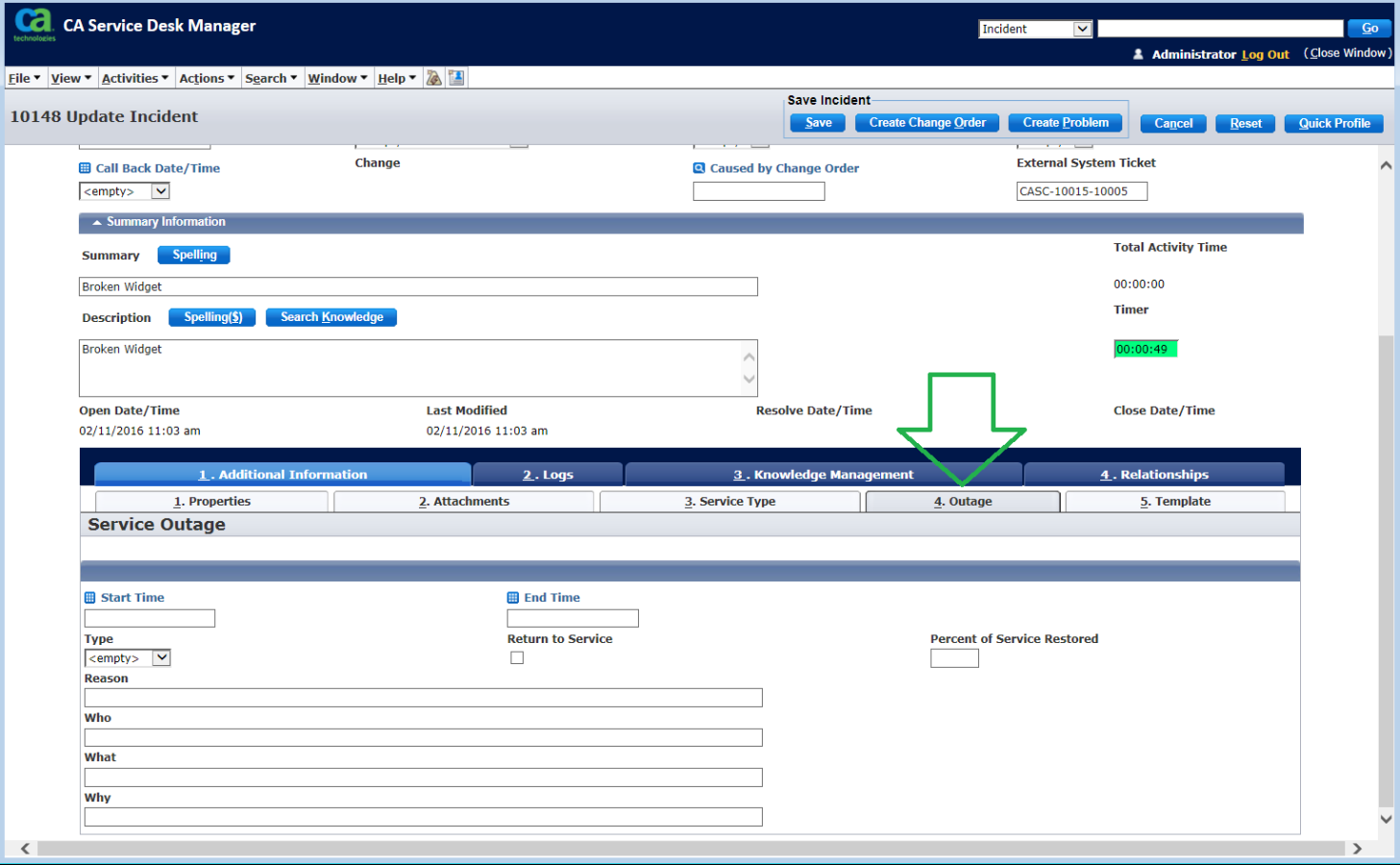

    Hello Joe,
    Not quite with what you're trying to do.
    1) I take it that your "4. Operational" tab is a new custom tab that you've added to the Incident?
    2) What version of SDM/ITSM?
    3) Maybe you could have a look at the form that currently does "Outage?" It contains examples of fields on a form that allow direct user input when in Edit mode.

    When a search is done for incidents there is a list of results. Right-clicking on one of the results gives you a menu and from there you can Log a Comment.... for instance. Want to add an option to this right-click menu to open the ticket to this Operational tab and have the ticket in edit mode, or have it open a form that updates the ticket like Log a Comment... does
    1. We renamed Outage and added some custom checkboxes to it. This was done before I got here.
    2. SDM 14.1 cum#2
