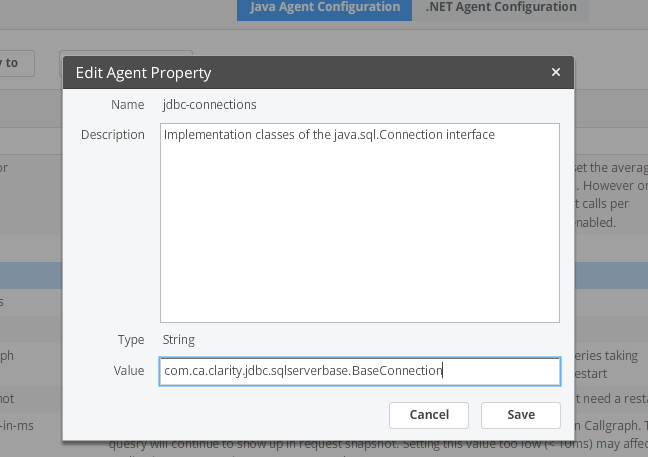

Step 4: Update the following properties with values as below
For example jdbc-connections:
property name=jdbc-statements
value= com.ca.clarity.jdbc.sqlserver.dda
property name=jdbc-connections
value= com.ca.clarity.jdbc.sqlserverbase.BaseConnection
property name=jdbc-prepared-statements
value= com.ca.clarity.jdbc.base.BasePreparedStatement
property name=jdbc-callable-statements
value= com.ca.clarity.jdbc.base.BaseCallableStatement
