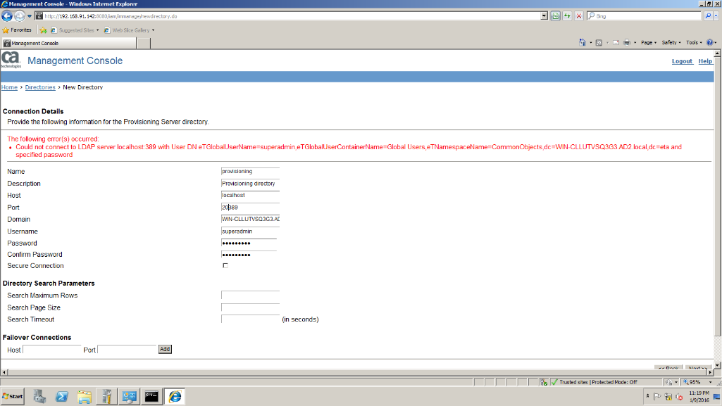

    Hi ,
    i am trying to create a provisioning directory through management console but i get this error >>
    The following error(s) occurred:
    Could not connect to LDAP server localhost:20389 with User DN eTGlobalUserName=superadmin,eTGlobalUserContainerName=Global Users,eTNamespaceName=CommonObjects,dc=WIN-CLLUTVSQ3G3.AD2.local,dc=eta and specified password
    Regards.

    Hi Mohammed
    you have to tell us what is you setting , have you install the CA Directory and the provisioning on the same server as the IM or different machine ?
    But in general , I have noticed something from your screen shot
    the Domain part (just before the username) is not referring to the Active Directory domain , but to the Provisioning domain , which is by default called "im" ,, also I prefer that you put the machine name instead of "localhost" ,, even it will work .

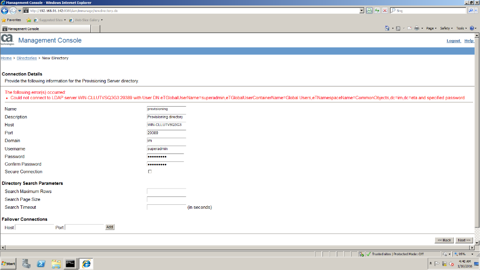

    Hi Wael ,
    Thank you for your reply ,
    -for my setting , i am using 3 virtual machines ( IDM server " CA directory and provisioning server on the same server  " , DB server , AD server ).
    -after correcting the information i got this error .

    Hi Mohammed
    So you have installed all on one machine (CA Directory, Provisioning Directory, Provisioning Server, and IM)
    is the provisioning Directory installed successfully ? try user the Provisioning Manager setup , enter the hostname with the default port 20389 , then configure ,, it should show you the Domain name = im , Domain suffix = dc=im and the TLS port.
    if it fails , then you must review the installation logs to see what fails.
    if you need my advice , you have to separate the Provisioning server (CA Directory , Provisioning directory and Server ) away from the IM , you can install them on the DB server ,,, this will clarify lot of things during your testing , and it similar to production environment.
