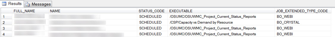

    Here's my contribution back to this thread. Business Problem to Solve: I need to ensure users are migrating over to Jaspersoft for their Reports. I need to identify all Business Objects Scheduled Reports and their creators.
    SELECT
    R.FULL_NAME
    , J.NAME
    , J.STATUS_CODE
    , D.EXECUTABLE
    , D.JOB_EXTENDED_TYPE_CODE
    FROM CMN_SCH_JOBS J
    JOIN CMN_SCH_JOB_DEFINITIONS D ON D.ID = J.JOB_DEFINITION_ID
    JOIN SRM_RESOURCES R ON R.USER_ID = J.CREATED_BY
    WHERE J.STATUS_CODE = 'SCHEDULED'
    AND D.JOB_EXTENDED_TYPE_CODE LIKE '%BO%'
    ORDER BY R.FULL_NAME
  • 7.  Re: Scheduled Reports Table (Clarity)
    Posted Dec 08, 2016 10:30 AM
    The full set we're using...
    -- All Scheduled Reports
    SELECT
    R.FULL_NAME
    , J.NAME
    , J.STATUS_CODE
    , D.EXECUTABLE
    FROM CMN_SCH_JOBS J
    AND D.JOB_EXTENDED_TYPE_CODE LIKE 'BO%'

    -- All Scheduled Crystal Reports - these users need to move to Jaspersoft Nao
    SELECT
    R.FULL_NAME
    , J.NAME
    , J.STATUS_CODE
    , D.EXECUTABLE
    FROM CMN_SCH_JOBS J
    AND D.JOB_EXTENDED_TYPE_CODE LIKE 'BO_CRYSTAL'
