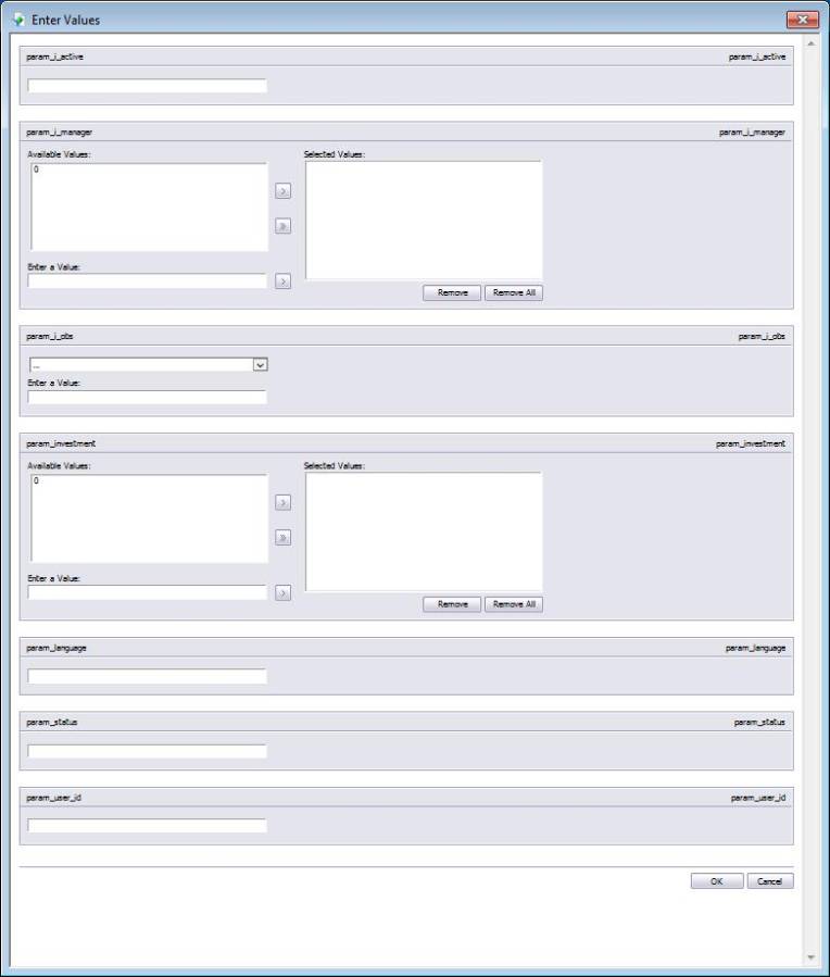

    I'm trying to add a field to an OOTB crystal report but when i update the query in the edit command section it prompts me to enter the parameter values.  When i try entering parameter values it gives me the following error:  "Failed to retrieve data from the database.  Details: ORA-00904:: invalid identifier".  Does anyone know how to save the query without having to enter parameter values?  Or possibly figure out a way to find correct parameter values so that i'm able to save the report.  I tried running the report and exporting the crystal report and entering the parameters that show up in the "Show Current Parameter Values" section but that didn't work either.
    Thanks,
    Aaron

  • 3.  Re: How to edit OOTB Crystal Report SQL query with parameters?
    Posted Jul 15, 2014 10:53 PM
    Thanks Allen.  I tried getting the parameters from a report i ran in the central management console and entered it exactly as it is into crystal but it still gives me the same error.  It did not prompt me to enter the "param_host_server" or "param_plan_type" when trying to update the query in the Crystal Report command editor but those parameters don't exist in the SQL query.  All I really need to figure out is how to modify the SQL query for the report but i can't get passed the prompt to enter parameter values so i can save the query.  Any help would be greatly appreciated.
    Thank you,
    Aaron

  • 5.  Re: How to edit OOTB Crystal Report SQL query with parameters?
    Posted Jul 16, 2014 06:44 PM
    sorry, i'm a little confused.  I've written some custom crystal reports and uploaded into clarity but never edited an OOTB report so i'm still really newb.  I am working on the project storyboard report on version 13.3.0.286.02.19 of clarity in crystal reports 2008 and have saved it locally to my computer.  When i open it in crystal reports and go to command the query looks different from yours.  I pasted it below so you can see it.  I just want to be able to edit this query but when i go to the command editor in crystal and make changes i get the prompt for parameters but it never seems to work when i enter it in.  I used the parameters in the picture i posted above but I don't see any values in the browser url when i run the report.  Thanks for taking the time to help out though I really appreciate it.

  • 6.  Re: How to edit OOTB Crystal Report SQL query with parameters?
    Posted Jul 23, 2014 06:51 PM
    Apparently when you change attributes to an object you lose the ability to view certain tables so that is what was causing me to get the error.  I opened up a support ticket to add back the ability to view ODF_Project_V2 and it should clear up the issue.
