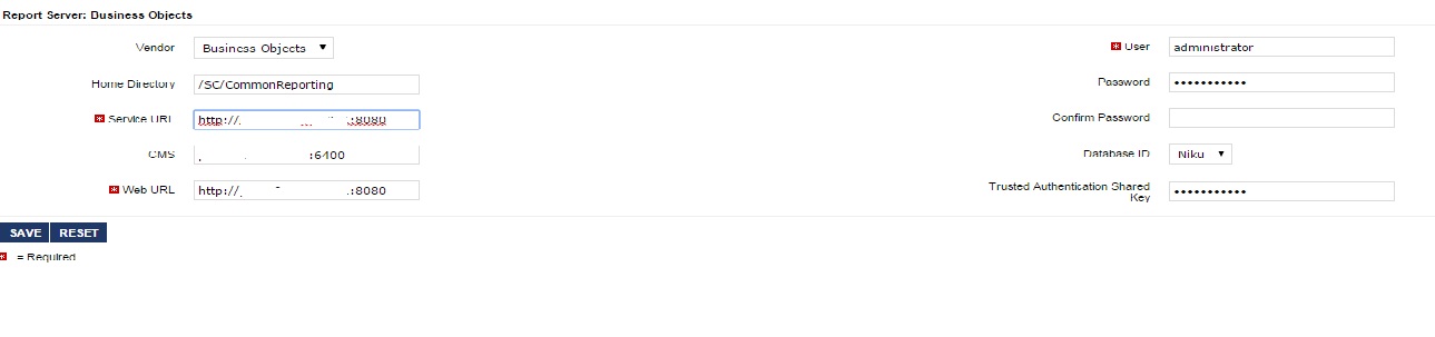

    You should also allow the port numbers you use for service URL & CMC port.
