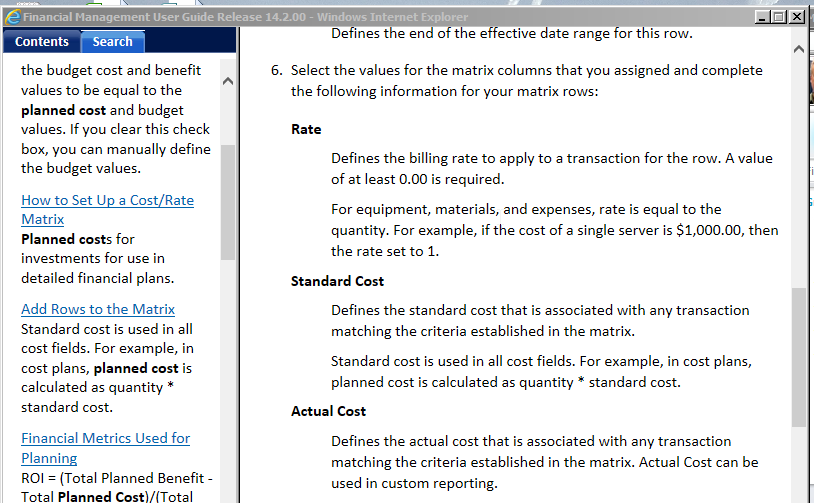

14.2 Help indicates Standard Cost is used for all cost fields, including Planned Cost:

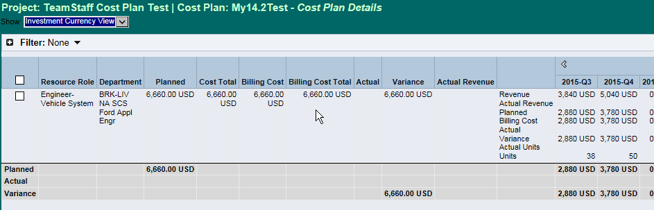

Standard cost is set to $50 (all figures in screens are fake - just for testing purposes!):
My test project has 38.4 hours in 3rd Quarter. Therefore, Planned Cost should be $1920.00:
Value displayed is $2880 - the result of 38.4x the Actual rate of $75!!!!
Standard Cost should be used for planning purpose, as described in Help documentation. Instead, Actual Cost is being used for both planning and actual transactions.
If I'm doing something wrong, would like to understand what and fix it. Right now, its not working as described nor as expected.
