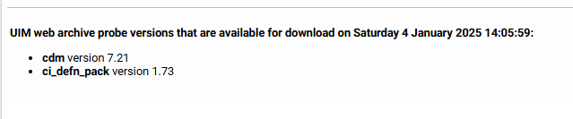

    If there is something common between all clients I visited in the past it is the difficulty they had to have a clear view on what probes/packages and their versions that were installed in their environment.
    Via the good old Infrastructure Manager we could drag and drop a new version of a probe, but it was not always easy to see/check the total picture/results.
    The attached tool, available in Perl source and compiled format, will try to get the highest available version from your LOCAL & WEB archive and compare this with the information available in the centralized table: cm_nimbus_package.
    Input:
    To help you create specific target reports you have several:
    - sql filter parameters: -lo, -lh, -lr and -lp
    - on the output of the created sql query you can apply regex parameters where you can filter on: origin, hub, robot, package, os_major_os_minor, user_tag1 and user_tag2
    Output:
    - html report with in red all robot/probe that have lower versions installed
    - PU txt file with commands ready to be executed to upgrade the probes (they are NEVER executed/deployed/upgraded automatically)
    This example was run with parameters -ex"n"
    (-ex"n" is to report also the probes that have a correct version installed)
    In the PU txt file you can find:
    Doc file is also included in package/attachment

    -option -wa"y" will try to access: support.nimsoft.com:443 directly to report on available versions in web archive (see above screenshot where the CDM probe has version 7.20 available in web archive).  If somebody find the exact customization actions/steps to open this access in a closed environment, please let me/us know.

  • 31.  RE: Tech Tip: robot/probe version checker and report tool
    Posted Jan 04, 2025 08:09 AM
    Edited by Luc Christiaens Jan 22, 2025 05:29 AM
    Version 2.6.5:
    • minor updates to recognize some probe versions exceptions
    • new options -sw: use swithmail and -et: email to will generate when using -wa"y": check web archive a new report with the "new" web archive packages that are available and not downloaded in your local archive
    • updated doc to explain how you can implement/use swithmail very quickly.  (instead of using Blat).  Swithmail supports smtp servers that require TLS.
    Example email with 2 new web archive packages available:
    An extra note about the -ci parameter.  This option, when set to "y", can report/list all packages that have something abnormal, like being deployed, but no version in local archive (anymore). This option is set by default to "n".
