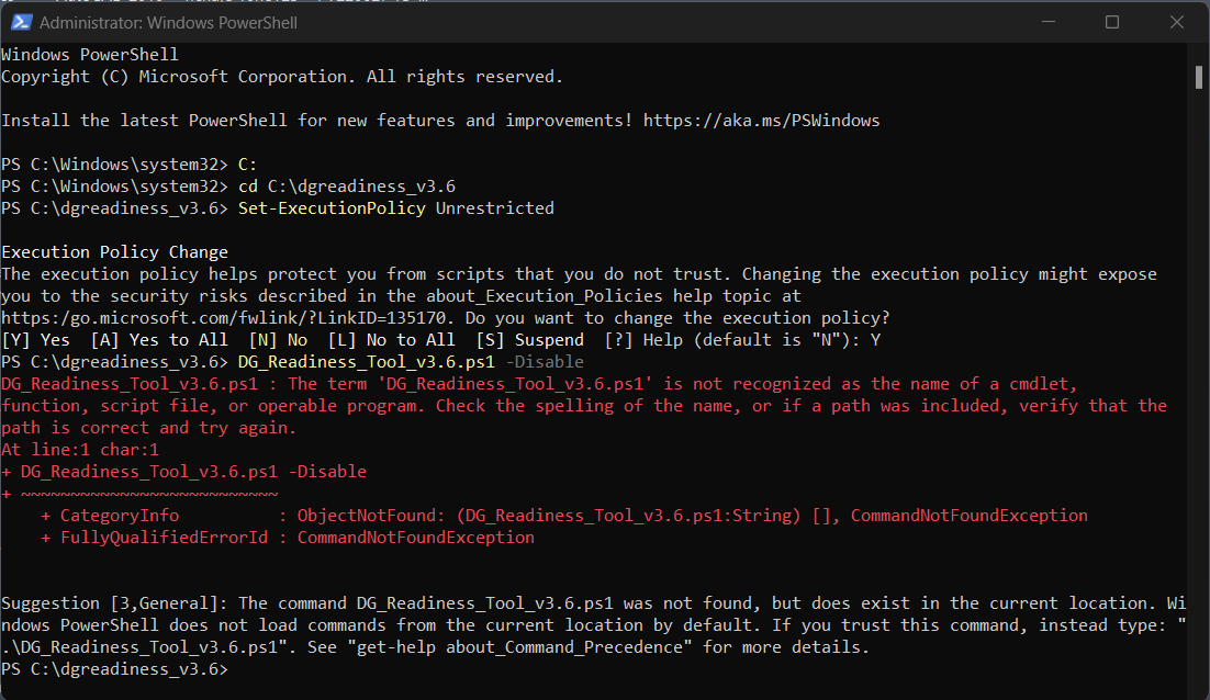

    For case (b) I have seen both, the "ULM" value in the log file and the virtualization based security enabled in the system information. So this seems to be the problem.
    I followed @svenmerget post and after doing phases 1 and 2, VBS is still enabled, so I moved on to phase 3.
    At this point for some reason the script doesn't seem to be running for some reason. I am not proficient with powershell so I would appreciate more help.

    Personally, I haven't tried the steps. But that post is probably more comprehensive that pointing you to other threads that can be quite piecemeal in presentation.
    Anyway, svenmerget replied in the same thread to the same problem, his suggestion is to put a .\ in front so Powershell knows it is referring to a file and not a built-in command/object.
    .\DG_Readiness_Tool_v3.6.ps1 -Disable

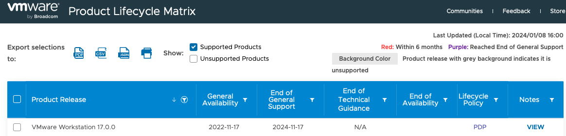

    The default lifecycle policy (EOL date) for VMware's desktop virtualization products is 15 months after release of the major version. They will extend that from time to time (for example, the EOL date of Workstation 17 is 2024-11-17 and I believe that's because of the release of 17.5).
    Here's the info from the product lifecycle matrix
