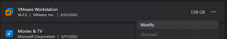

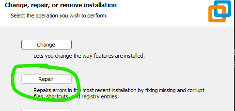

  • 94.  RE: Mouse flicker in guests
    Posted Jun 06, 2022 09:06 PM
    I found a simple solution that worked.
    windows settings > apps > installed apps > vmware
    click the elypses menu and hit modify. that'll pop up a setup wizard. make sure vmware is shutdown before clicking "next"
    hit repair and let it do it's thing. you will have to restart once it's done.
    This has solved flickering and sluggishness in one go and I didn't have to modify and .conf files.
