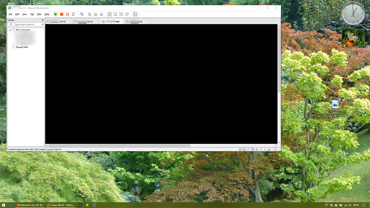

    After having upgraded to VMware Workstation 15 on my Windows 10x64 machine, each of my VMs shows a black flicker from time to time (once every 10 minutes or so).
    This disturbance can be reproduced easily:
    Simply start a VM with a Windows 10x64 OS installed and wait for about 10 seconds after having signed in to the guest OS. Then the first black flicker will occur:
    After having opened a support ticket I'm having long discussions with VMware Support. They don't seem to be able to reproduce this issue.
    So I'm asking here: Can anyone reproduce this issue?

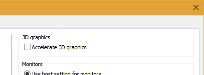

    To both WhiteKnight and bluefirestorm, do you still see the flickering if you disable 3D graphics in the VM ?
  • 6.  RE: Workstation 15: Guest screen flickering occasionally - can someone reproduce this issue?
    Posted Nov 28, 2018 05:13 PM
    Thanks, bm​, for trying to help.
    Yes, even after having 3D acceleration disabled, the flickering still occurs.

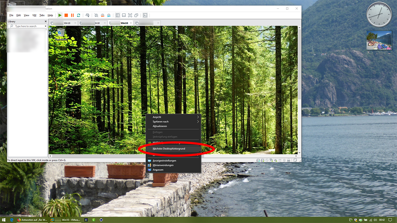

    I had this flicker happen every time my Windows 10 background wallpaper would change on the host machine (once every 10 minutes).

      1. switch to VMware Window mode,
      2. go to host OS (Windows 10, having a multi-image Windows theme installed there)
      3. right-click on the host OS desktop and select "next desktop background" from the context menu that appears:
    This is making me wonder if the NVidia graphic drivers are having a bug again, causing VMware workstation to fail (i.e. flicker).

    For me this problem happen when I run graphically incompatible application that was not originally made for newer OS.
    Did you try disabling 3D graphics acceleration under VMware setting.
  • 53.  RE: Workstation 15: Guest screen flickering occasionally - can someone reproduce this issue?
    Posted Jan 29, 2021 07:44 PM
    I did. And, it worked, but the performance of the VM became _very_ slow.
