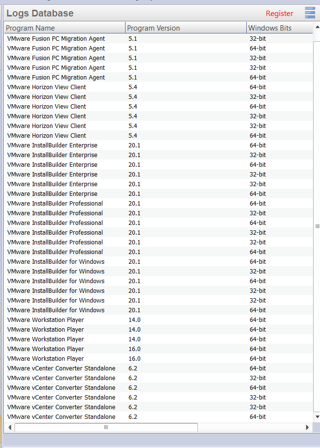

    More than one of the screenshots talk about an old version and your installation being an upgrade, I suggest looking for old files, folders, registry keys, and devices.
  • 5.  RE: problem installing Vmwareworkstation
    Posted Nov 24, 2023 10:58 AM
    when removing, I used the "Uninstall Tool" program. After deletion, nothing is displayed when searching on the computer

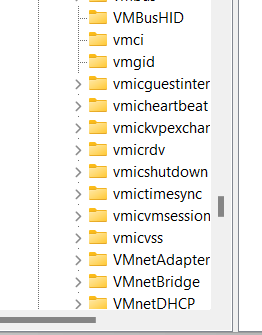

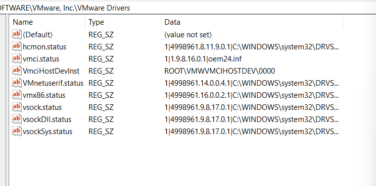

    I searched a bit and found drivers, etc. But I doubt what can be deleted and what should be left.
