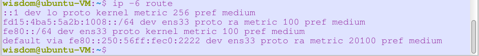

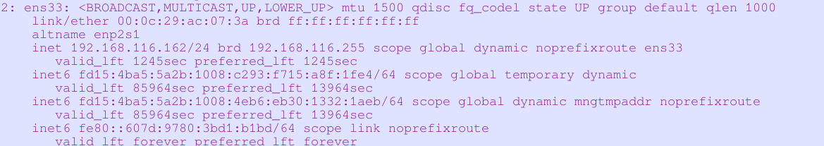

    Yes, I think it works. I was having issues the other day because the host did not have a globally routable address. I moved to a different net today, and can confirm it works.
    Having said that, I do not think it is very stable. The connection flaps up and down, with no known changes made to either the host or the VM. I don't really know whether its a VM issue or a Hypervisor issue.
    wisdom@ubuntu-VM:~$ ping 192.168.116.2
    PING 192.168.116.2 (192.168.116.2) 56(84) bytes of data.
    From 192.168.116.162 icmp_seq=20 Destination Host Unreachable
    From 192.168.116.162 icmp_seq=24 Destination Host Unreachable
    From 192.168.116.162 icmp_seq=25 Destination Host Unreachable
    From 192.168.116.162 icmp_seq=26 Destination Host Unreachable
    From 192.168.116.162 icmp_seq=27 Destination Host Unreachable
    From 192.168.116.162 icmp_seq=28 Destination Host Unreachable
    wisdom@ubuntu-VM:~$ ping ipv6-test.com -c4
    ping: ipv6-test.com: Name or service not known
    So it flaps from working to not working spontaneously and with no changes made to either host or guest.
