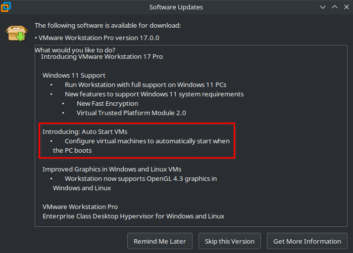

    Sitting in the same boat now and I'm kinda disappointed since the update panel clearly said there will be such a feature:
    After upgrading I have absolutely no clue where I could find such feature.

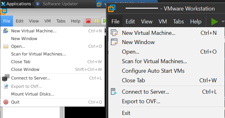

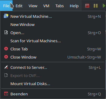

    From what I've gathered there should be an entry in the files menu:
    As you can see, there is nothing indicating such feature.
    The biggest issue I have now is, after upgrading from an older 16.1 version which still had the shared vm feature, I'm left with "nothing" and need to start the machines via a cron job to have them running after I reboot the host.

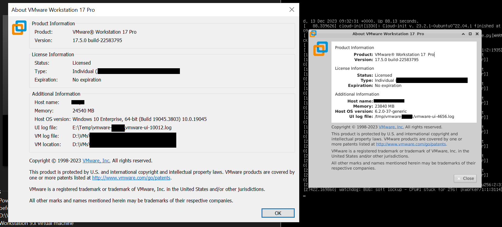

    I remember 15 having it, 16 did not. Now I've upgraded to 17 (17.5.0) and in windows, I see it, but ubuntu, I do NOT.  Having upgraded just for this feature and not finding it, I feel that my money going towards vmware just isn't worth it anymore for this kinda crap.  I upgraded for less because of the existing license and a black Friday sale, glad I didn't give them any more!  While they still have great software, this lack of features across platforms is astounding, and I hope they come out with a patch soon!  vmwareversions.png
