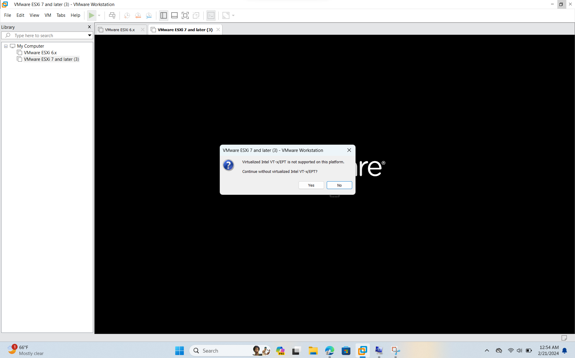

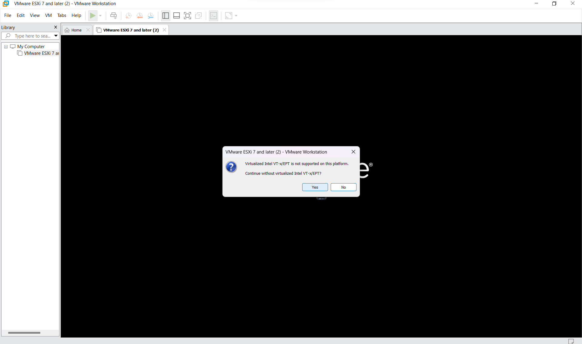

    Dear team,

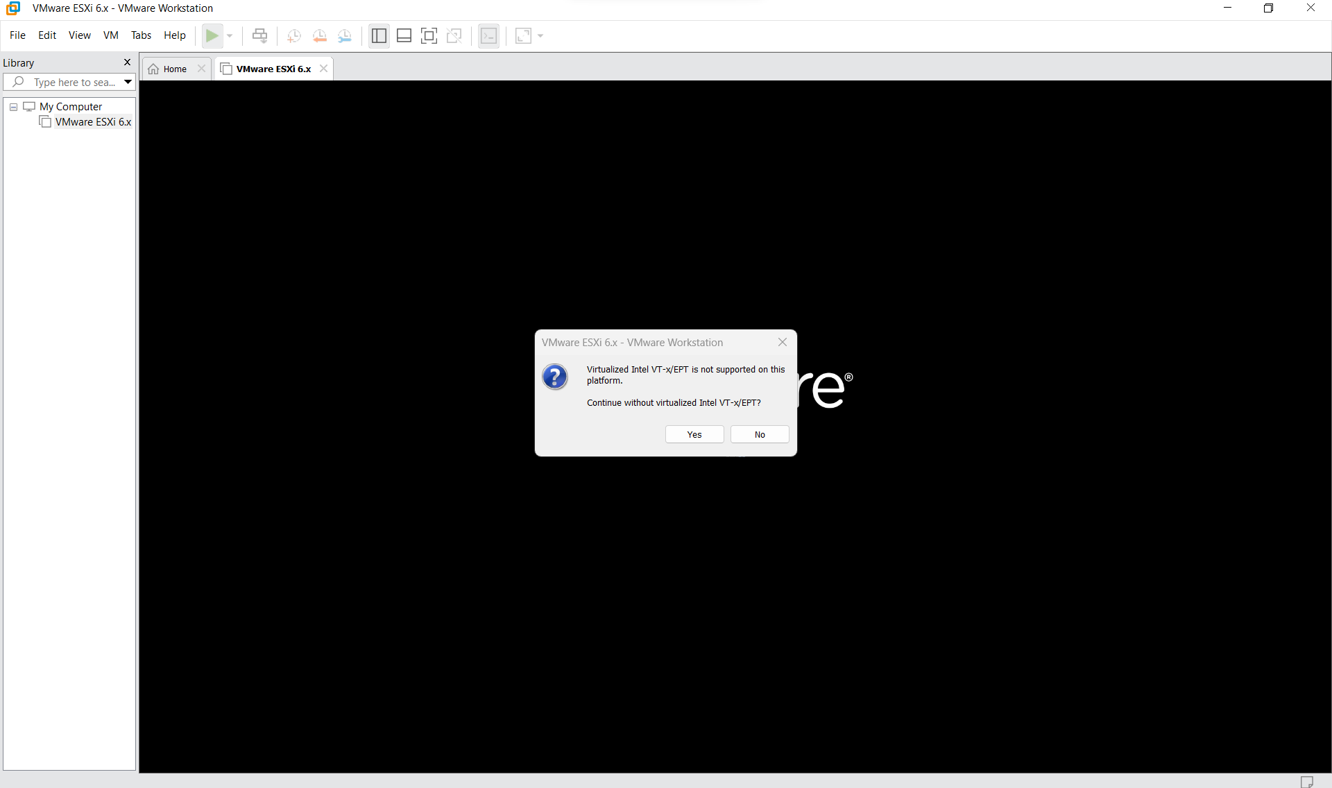

    I'm trying to deploy the ESXI 7.0 & ESXI 6.0 over the VMware workstation however getting the attached error. As per the below error I already Enabled the Intel Virtualization technology in BIOS prompt window.
    It's strange to understand the gap from my side for ESXI configuration. All the laptop Hardware configuration and ESXI configuration in below attached Snapshot. could you please help to understand the configuration gap.
    VMware Workstation version: 16.2

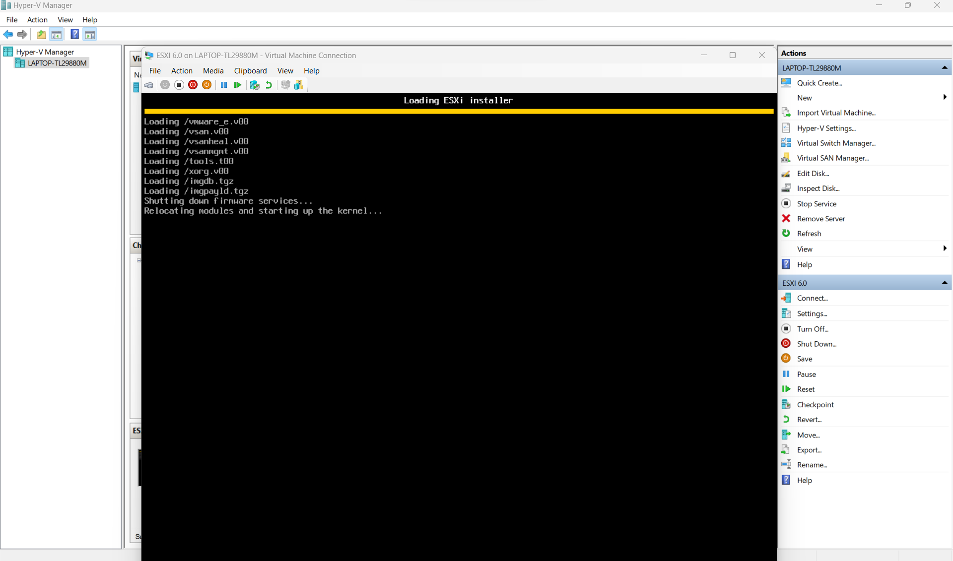

    When I 'm trying to deploy ESXI 6.0 from Hyper-V Platform then it's stuck after power on as per below screen shot.

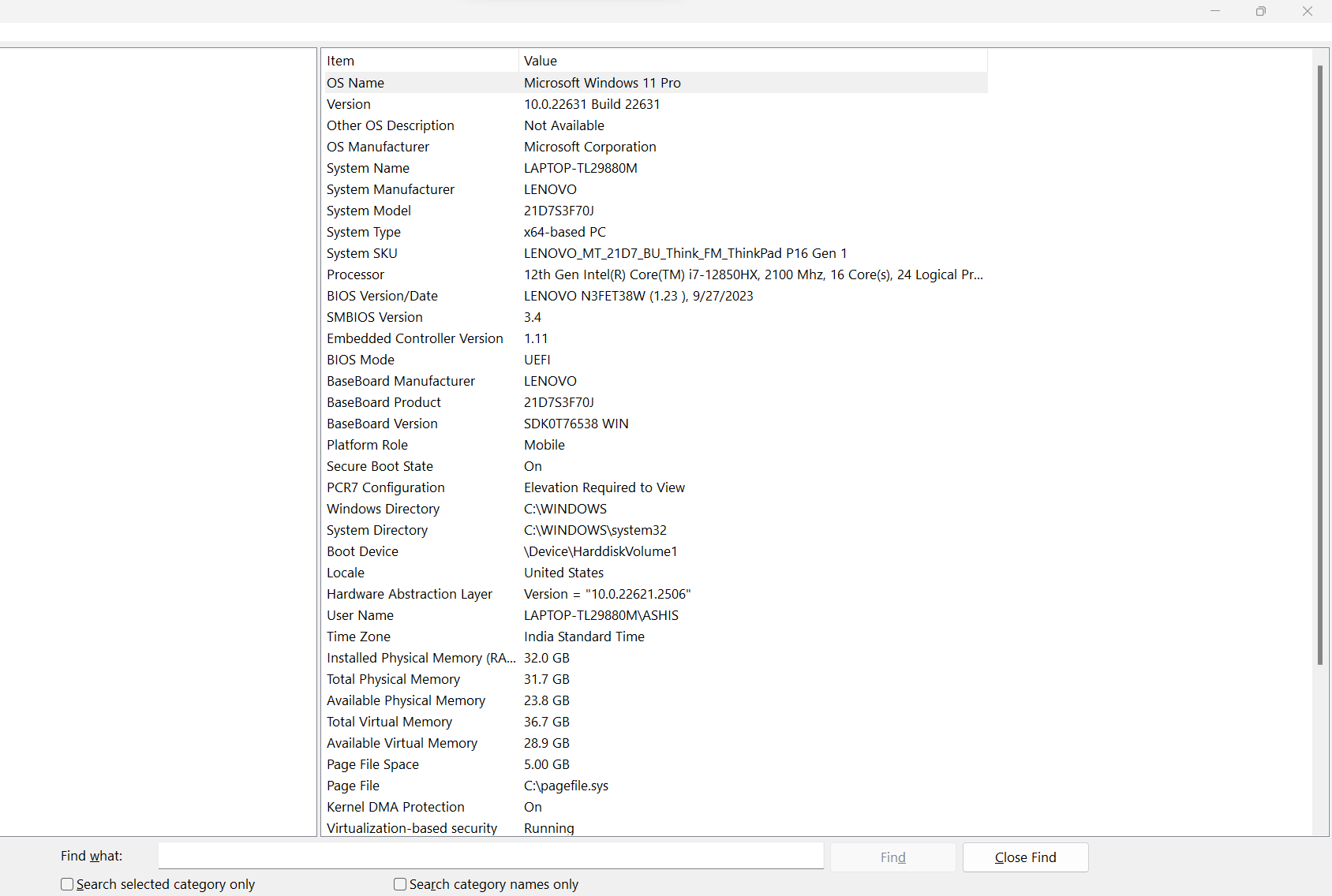

    Original issue "Virtualized Intel VT-x/EPT is not supported on this platform" is because Hyper-V is detected on the Windows 11 host. Even if it is not explicitly installed, Hyper-V can be running due to other components like WSL2, VBS, Sandbox, etc. From the msinfo32 screenshot, it looks at least VBS is running (that means Hyper-V is active on the host).
    Unrelated to the Hyper-V issue, the host has a i7-12850HX CPU, which means it has e-cores/p-cores.
    Have a look at this post to see how to remove Hyper-V and options to address the e-core issue.
    https://communities.vmware.com/t5/VMware-Workstation-Pro/VM-Workstation-Windows-Slow-Performance/m-p/3002917#M184504

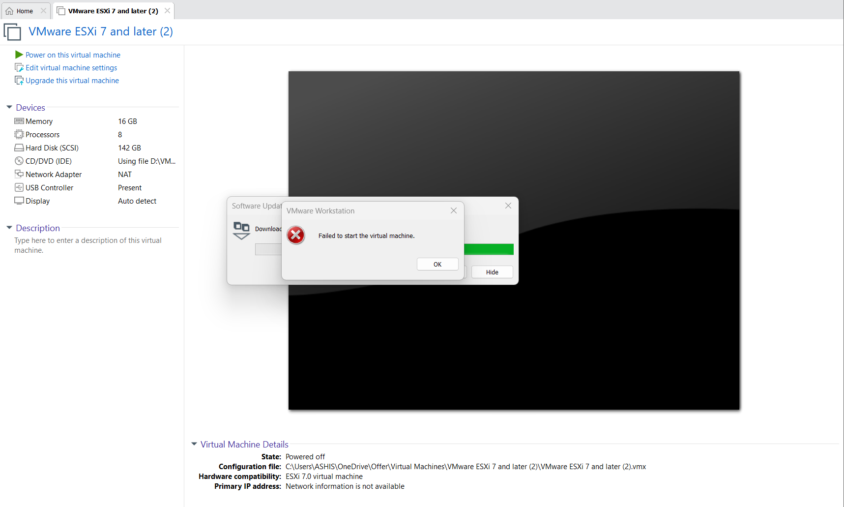

    Third issue the VM is stored on OneDrive (from the 2nd screenshot). Do not run VMs while they are stored on OneDrive or any cloud-based storage if you value your sanity and do not want your virtual disks getting corrupted frequently. Install and run your VMs off local storage.

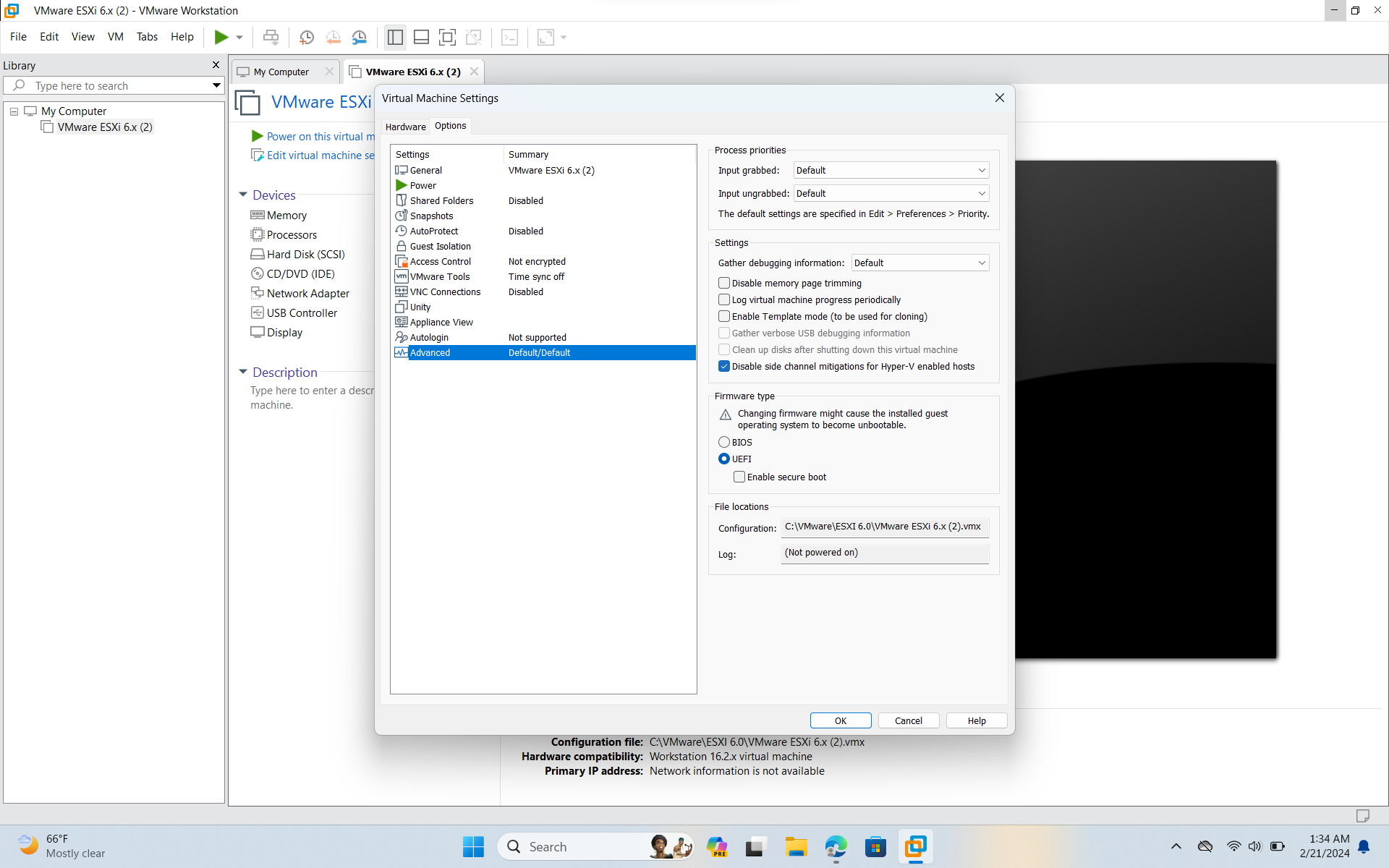

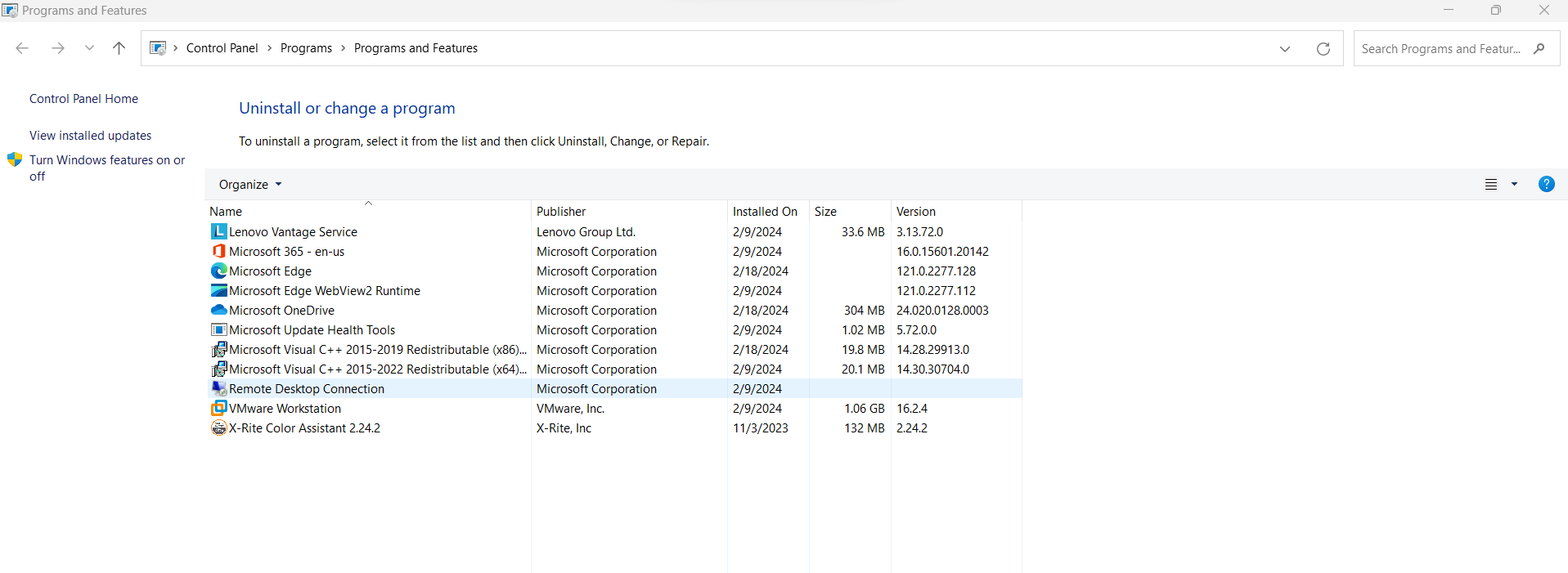

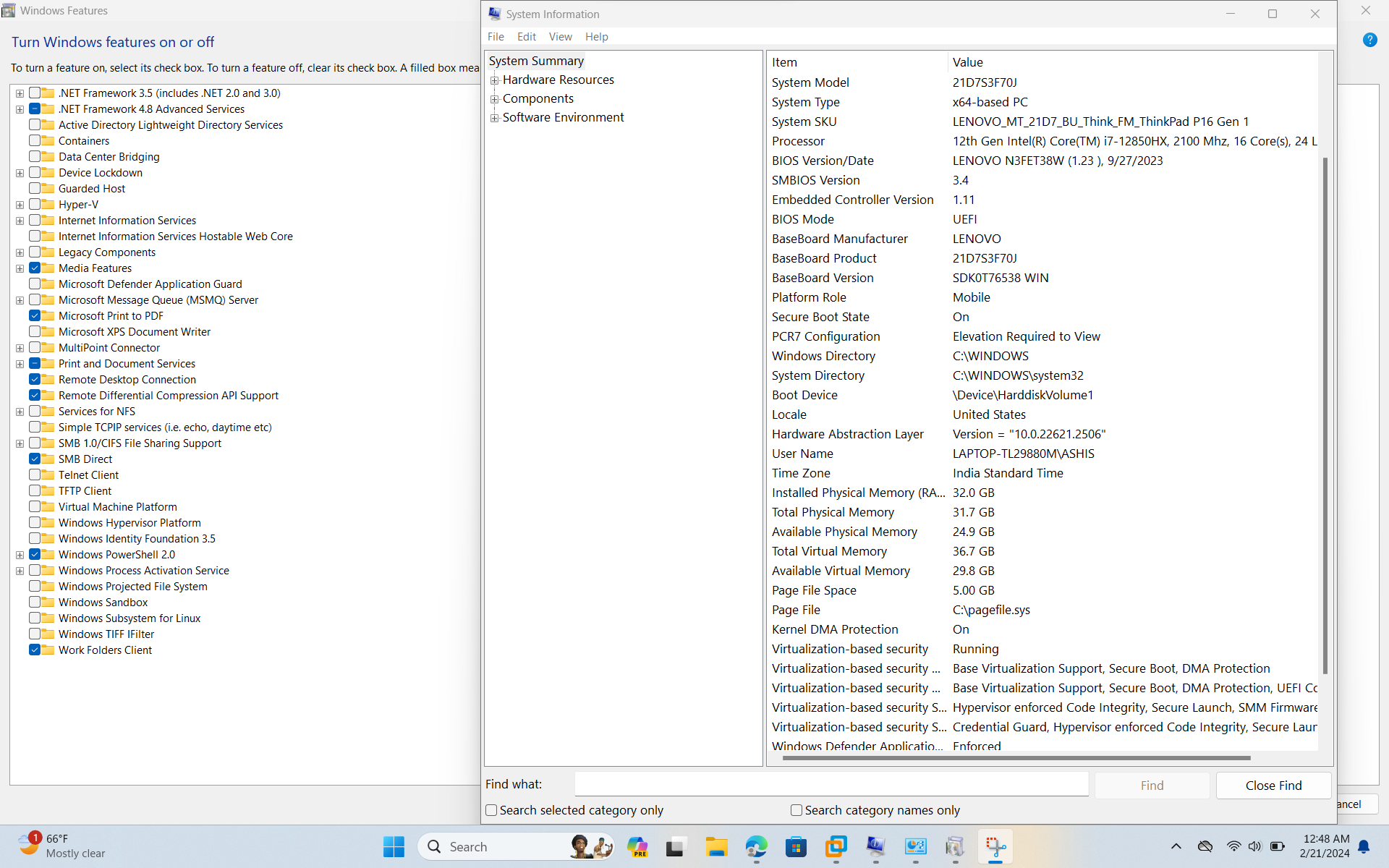

    Thank you for your quick response. However, I have disabled Hyper-V from control panel but still unable to load the ESXI 6/7 from VMware workstation.  Even Configuration files saved in local drive as per your suggestion.
    Also, I haven't installed the WSL in my system. Firstly, I'll happy to go VMware workstation issue with ESXI setup. All the screen shot will help you to understand as in better way.

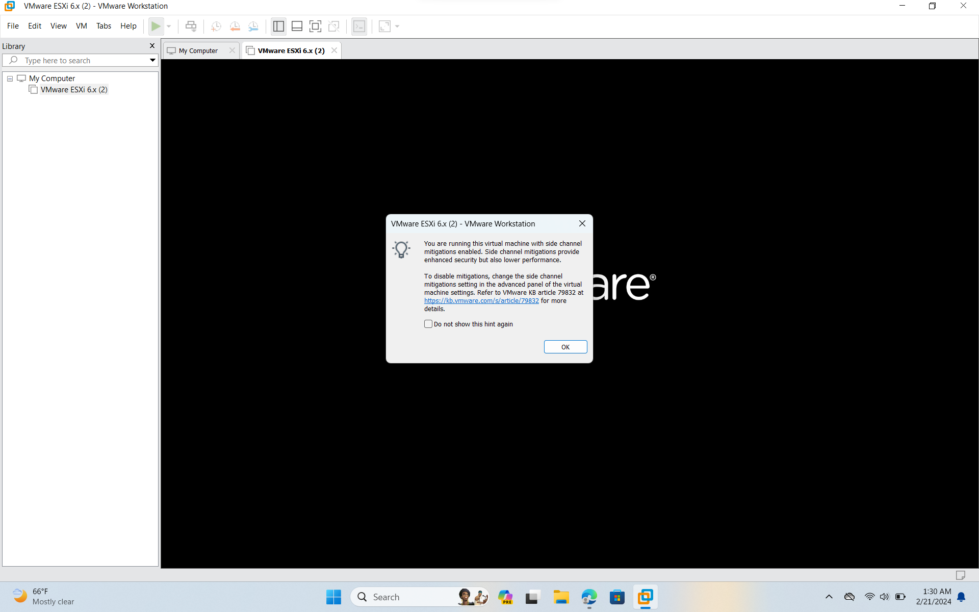

    While power on the ESXI getting some message so I have disabled the mitigation from VM setting. see the alert message in Screen shot 2.

    The msinfo32 screenshot still shows "Virtualization based security" - "Running" just like your original post. That means Hyper-V is still running as VBS is running. Other visual cues is the checkbox "Disable side-channel mitigation" will not show up if Hyper-V is no longer detected.
    Please read through that lengthy post.
  • 7.  RE: ESXI 7.0 Installation over the VMware Workstation
    Posted Feb 24, 2024 05:20 PM
     Thanks you for your suggestion. After doing your suggested step I'm able to install the ESXI over the VMware workstation pro.
