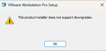

    I'm having a similar issue with kali, it started when I upgraded to 17.5 around 10/20/2023.  My ubuntu vm doesn't seem to freeze.  I've downgraded the hardware compatibility and tried installing a fresh vm from the kali website.  Sometimes I'll get 5 minutes, sometimes I'll get 15 or more, but eventually it freezes.
    I don't know what data to collect and post here to help diagnose things.  My host is Windows 11, I've tried following the instructions here https://learn.microsoft.com/en-us/troubleshoot/windows-client/application-management/virtualization-apps-not-work-with-hyper-v without luck.
    I tried to downgrade to 17.0.2 but the Workstation installer wouldn't allow me to.

    Can't help with the freezing part, but if you want to "downgrade" your Workstation, you must uninstall the existing version first, then install the older version (might need a reboot in between).
