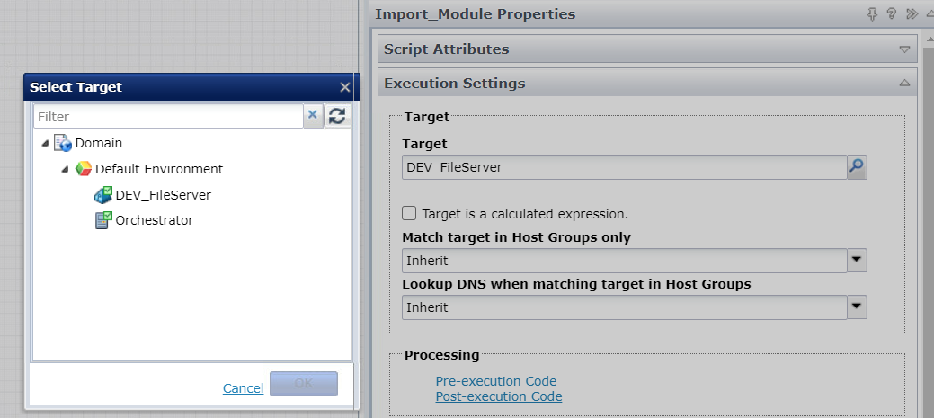

On the Execution Settings for the Script Operator I have the target set to the file server that is configured in my default environment. From there I saved my module files in folder on the server that we have configured.

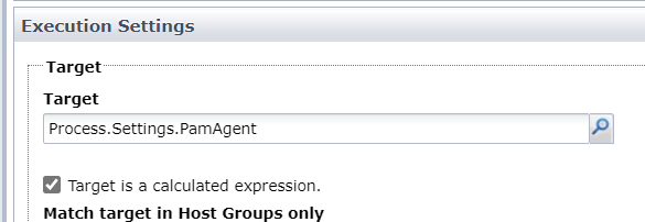

When in production we run the that value in a Variable populated from a dataset. If you do that you'll need to check the "Target is a calculated expression" box.
Hope this helps!
