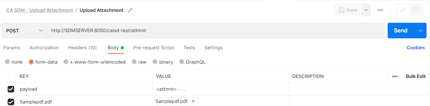

  • 11.  RE: Re: Upload attachment SDM API REST returns BadRequest
    Posted 12 days ago
    Hi
    is there is way to do it through form data like below
    payload is below
    <attmnt>
      <repository id="1002"></repository>
      <orig_file_name>Samplepdf.pdf</orig_file_name>
      <attmnt_name>Samplepdf.pdf</attmnt_name>
      <description>Test upload</description>
    </attmnt>
