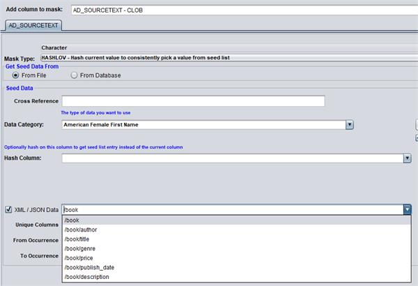

    Hi,
    We have column having xml data present in SQL and Oracle databases. is there any way to obfuscate it using FDM?
    Is there any way to replace only PII fields present in the column.

    Hi Ashish,
    Yes, FDM can detect the XML schema structure when you select the XML/JSON data checkbox.  You can select the XML node you wish to mask.
