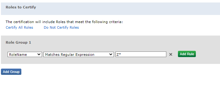

    During campaign creation you can filter what role you would like to include.  For Role start with N, you can use option "Match Regular Expression" with value like N*

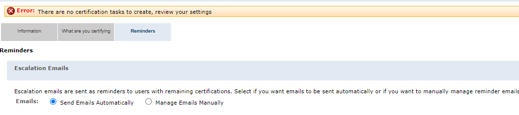

    But when i try to finish the campaign its giving an error.
    Is there anything that i did wrong?

    This tell you that your data that role name contain Z* did not have any task that need to be certified.  This has something to do with the data you have used.

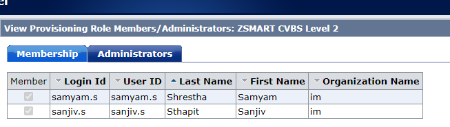

    But we have roles starting from Z.
    Also we have users assigned to those roles.
    Regards

    the regex would be "Z.*", not "Z*"

    After using  "Z.*" we are able to filter roles starting from Z.
