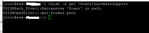

    Arnold Mishaev,
    from the command prompt of Your ESXi host, what is the output of the following command?
    vsish -e get /Power/hardwareSupport
    Lars
  • 11.  RE: Windows server 2016 react very slow and feel laggy
    Posted Nov 25, 2019 07:01 AM
    hello Lars,
    That is the output
  • 12.  RE: Windows server 2016 react very slow and feel laggy
    Posted Nov 26, 2019 11:44 AM
    ah.. you're running 6.5. Then the command requires a non-capital p in Power:
    vsish -e get /power/hardwareSupport
    Lars

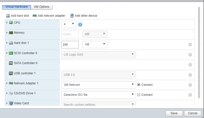

    Posted Nov 25, 2019 10:39 AM
    Hi
    Can you please share one of your windows 2016 VM configuration (screenshot of VM settings is great)?
  • 21.  RE: Windows server 2016 react very slow and feel laggy
    Posted Nov 25, 2019 12:50 PM
    Hi

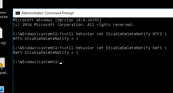

    The 2016 server issue is a known problem which I have confirmed to be solved by following the advice here:
    Windows Server 2016 Really slow on ESXI 6.5
    Thankfully I have also confirmed that 2019 does NOT exhibit the same issue, it works fine from the get go with no need to modify anything, and by "works fine" I mean it is fast just as any other OS when installed under ESXi (VM tools or no tools installed, it doesn't make any difference).

  • 24.  RE: Windows server 2016 react very slow and feel laggy
    Posted Nov 25, 2019 08:41 PM
    Hi BEArnold201110141​, I can only confirm that the issue for me was resolved while running 2016 standard, as for what the commands do, I am far from claiming Windows Server guru status but it has to do with the file system delete flag that for some reason takes forever on ESXi to complete, there's no loss of functionality or exposure to compromised data integrity with theses flags disabled but of course I can't vouch for this solution. All I can confirm is that it worked for me. However this is all moot point by now because the issue does not exist with Server 2019. I have confirmed that while being a bit skeptical when deploying new VMs since I expected to have to do the same thing by hand on those 2019 VM only to discover that they run fast and there is no need for a "fix"
