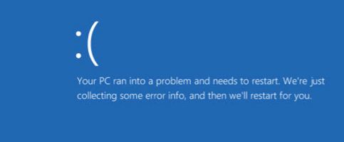

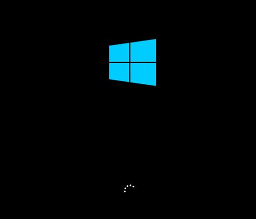

    Hello Gurus - I have a test environment vmware host that i have a few windows server 2008 R2 on. I did a in place upgrade on one from 2008 R2 to 2012 R2 Datacenter that worked fine. Now i have a microsoft web server 2008 r2 that I am doing the same thing as well. This time i go thru the upgrade steps then it reboots to the 2012 Windows icon with the dots spinning below it. It does that for about a minute or two then I get the "Your PC ran into a problem and needs to restart. We're just collecting some error info, and then we'll restart for you." message. Then it reboots to the same screen and does the same thing again. I looked online but there is so many different answers to this and i hate to have to rebuild a 2012 web server and migrate everything over. I have reverted the upgrade back to a vm snapshot i took before the upgrade. My vmware tools is up to date and i have checked on the microsoft technet but it seems to that it could be on the vm side. Im not sure because i was able to do a in place upgrade on one machine fine until i got to this one. Any help or direction i should take on this? Thanks!!

    So i re-upgraded and check Options. It still says Server 2008 R2 but i think because the install wasn't finish yet that is probably the reason. I get this screen below then it goes to a blue screen. Could this be the cause of VM or corrupted files?
  • 7.  RE: Windows Server 2008 r2 in place upgrade to server 2012 r2
    Posted Sep 18, 2015 03:45 PM
    The other message in the blue screen had "Inaccessible boot device"
