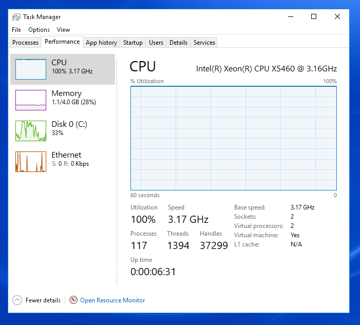

    Posted Aug 21, 2018 05:03 PM
    I ran the OS Optimaztion tool and it found some 70+ items but I'm still seeing the issue. These VMs are pegging at 100% just by opening up task manager. I find that hard to believe when I have 4 cpus assigned to the VM. My ESX host isn't over-subscribed. I just don't get it. It's gotta be something easy.

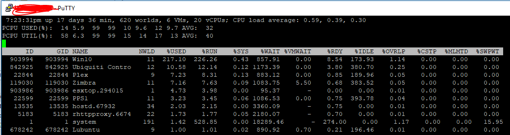

    Did you already check with ESXTOP to see if there are any issues with performance on cpu, mem and disk for these affected virtual machines.
  • 5.  RE: Windows 10 VM - Horrible Performance
    Posted Aug 21, 2018 07:25 PM
    This is the output, where WIn10 is the problematic VM.

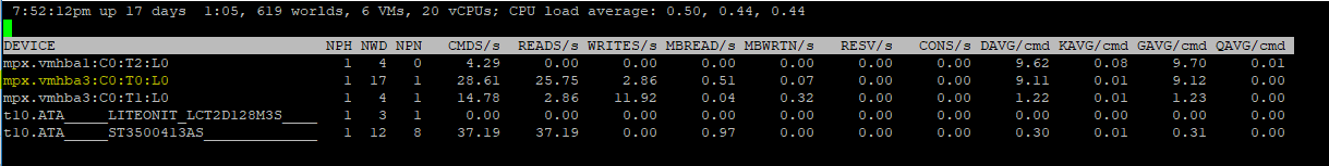

    Can you also check disk utilization?
    See VMware Knowledge Base

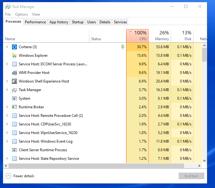

    What does the task manager show as the highest cpu utilization process?
    Use Process Monitor - Windows Sysinternals | Microsoft Docs as you would get more details about the running processes

    It's so bad I can't even run procmon.
    I even updated my ESX server to 6.5 U2 hoping there would be a fix but nada. Could there be an issue with the ESX install itself? Worth a re-install?
    Part of me thinks the VM isn't seeing all the processors.
